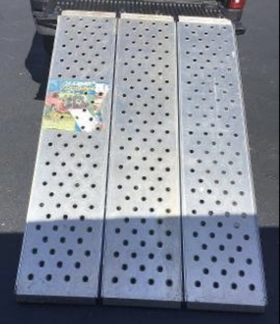

I’ve considered a trifold aluminum ramp,
but their weight is a little too high, as is their cost.

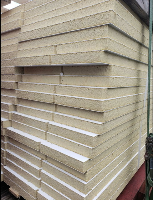

I just found this option on Facebook Marketplace.
The ad says:
“White fiberglass on both sides. 1.75 inch foam insulation 22 inches x 80 inches long. $9 each. R10 value. These are great for garages barns livestock areas few hundred available each panel is 12sqft. Pricing is firm at 75 cents per sqft.”
I asked the seller about their weight, and standing on them. He replied,
“Yes. They can be walked on I can jump on them leaning up I'm over 200lb. They don't budge … 20 pounds each.”
It’s heavier than I hoped, but it’s certainly cheaper than any other option I’ve found.

Those foam panels could work. You'll have to add some "hardpoints" to attach to the trailer frame but he price is right. Might make good wall/roof material too if you can glue securely to it. If you cover it with epoxy/glass cloth should be water tight. You could spline the panel joints. Doubt you'll be able to bend it though.
A pair of hollow core 24" doors. That would give you some framing around the perimeter to attach things to. Maybe a 3mm ply skin top and bottom.
Otherwise laminate your own torsion box style platform. Perimeter wood frame with foam core and 3-6mm skins.

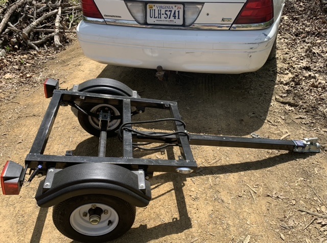

I found a cheap titled/ registered mini motorcycle trailer frame on Facebook Marketplace this week that I’ll be using for this mini foamie camper build:
The frame without the tongue is about 48”x48” including the wheels and fenders.
I plan on extending the tongue two feet, and building a 6.5’x4’ Foamie on it. It will slope up to a height of about 4.5’ at the rear, and will be a rear entry.
This trailer frame is a little heavier than I hoped, at 95 lbs, but I can work with that.

Postby GPW » Sun May 01, 2022 5:20 am
Cool little trailer ! 95 lbs. not so bad at all eh !!! 8) :thumbsup:
Re: Ultralight foamie floor/frame, pulling with a maxi scoot
Postby BrianInVA » Sun May 01, 2022 10:12 pm
GPW wrote:Cool little trailer ! 95 lbs. not so bad at all eh !!! 8) :thumbsup:
Yes, I’m pretty happy with it. It has a lot of potential. I just spent a half hour staring at it and looking at it all over. I’ll definitely extend the tongue 2 to 3 feet, and use the original tongue as a crosspiece over top the new tongue for the leading edge of the foamie floor frame. Then I’ll use five 1 1/2”x2” pine oriented longways for the floor frame. I just haven’t figured out yet what lightweight material to use as the actual floor to which I’ll attach the foamie structure.

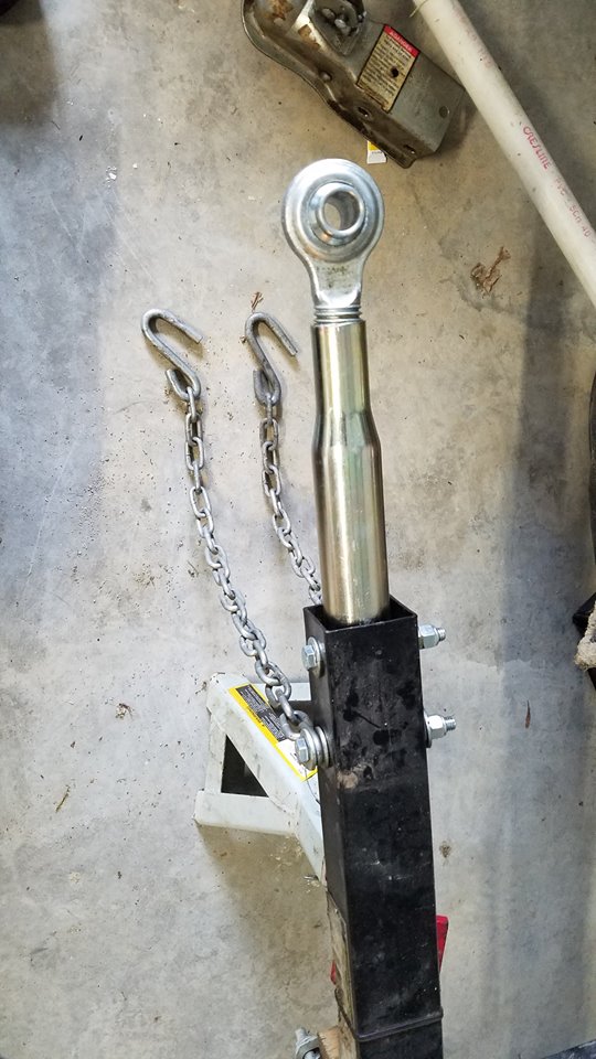

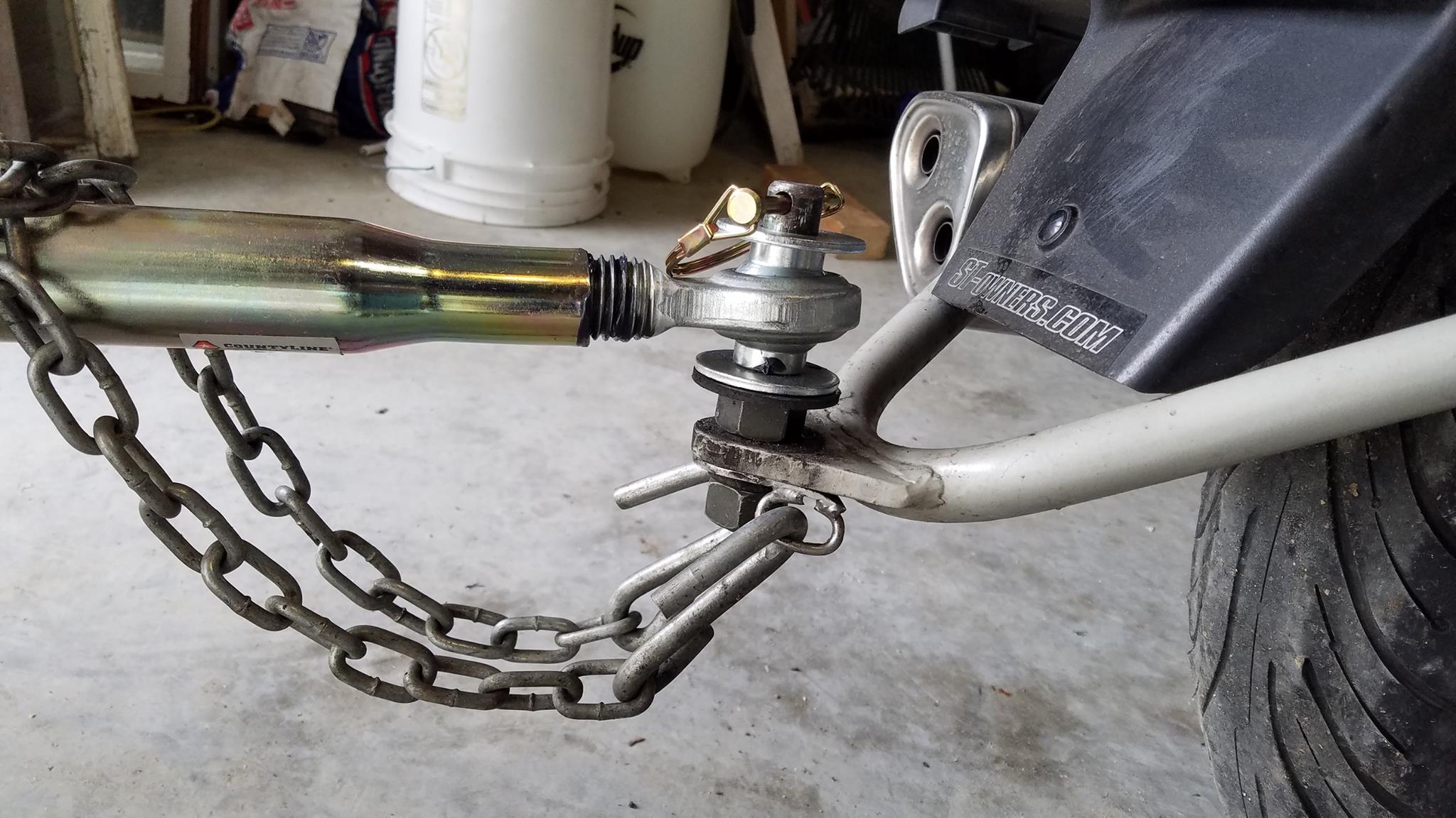

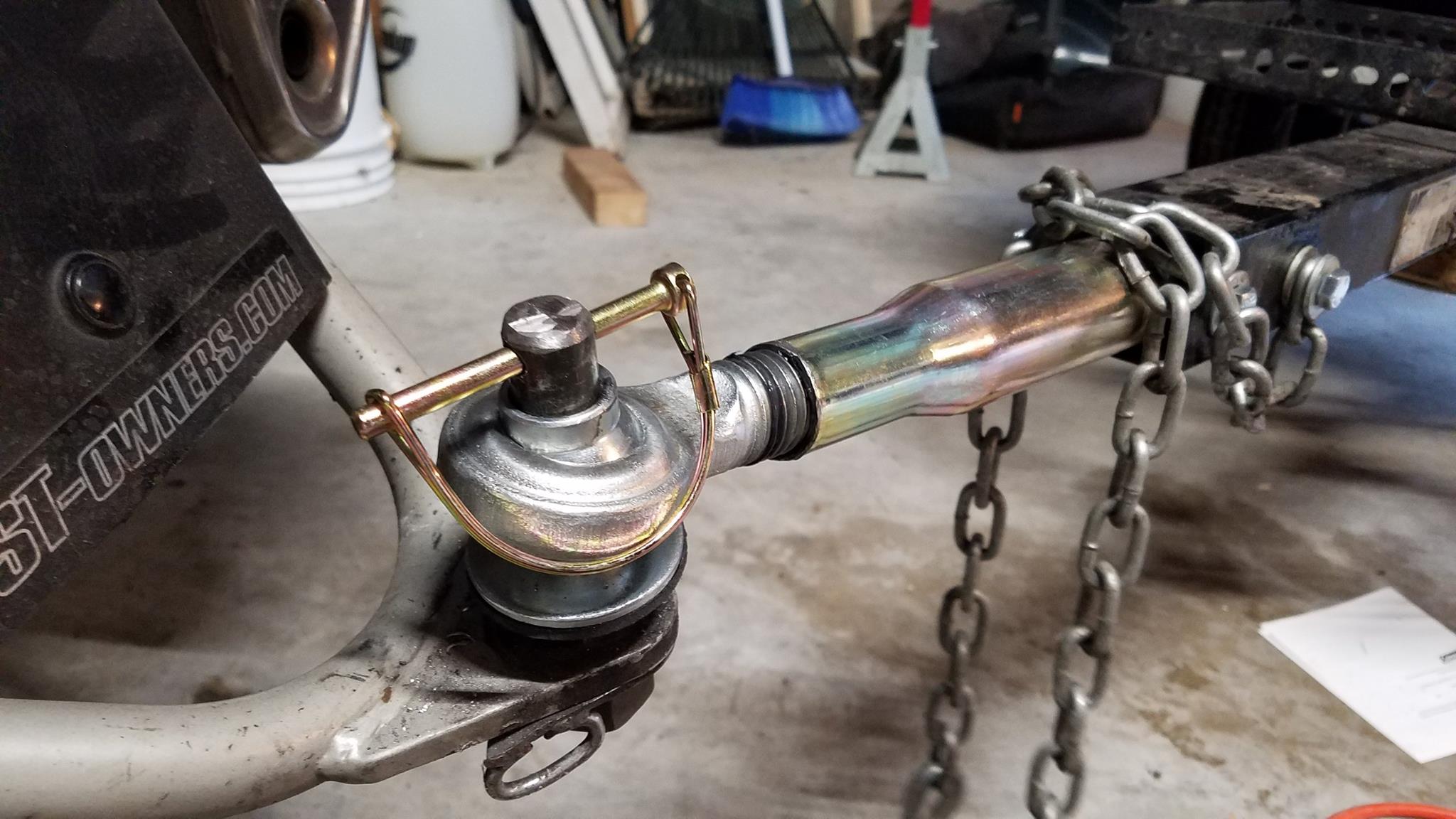

Also there’s a definite advantage of using a swivel hitch with a motorcycle trailer to allow the motorcycle to lean in a curve while the two wheels of the trailer stay on the road. Unfortunately I’m always looking for frugal options, and these swivel hitch upgrades all cost $150-$225.
I searched and searched and finally found a diy version of a motorcycle swivel hitch, using a Category 1 tractor top link inserted into the trailer tongue:

Postby rjgimp » Mon May 02, 2022 1:22 am
BrianInVA wrote: I just haven’t figured out yet what lightweight material to use as the actual floor to which I’ll attach the foamie structure.
Just use some of that awesome fiberglassed foam you found on farcebook. That will be plenty strong as you will only ever lie down on it, no walking.

Postby BrianInVA » Mon May 02, 2022 3:37 am
I thought it was closer but when I looked it up again, I realized it’s 270 miles away. 540 mile round trip. The gas would make it cost prohibitive.
If I took a sheet of xps and glued the Lowes fiberglass sheets they use for kitchens and bathrooms on each side, wouldn’t it be the same thing?
