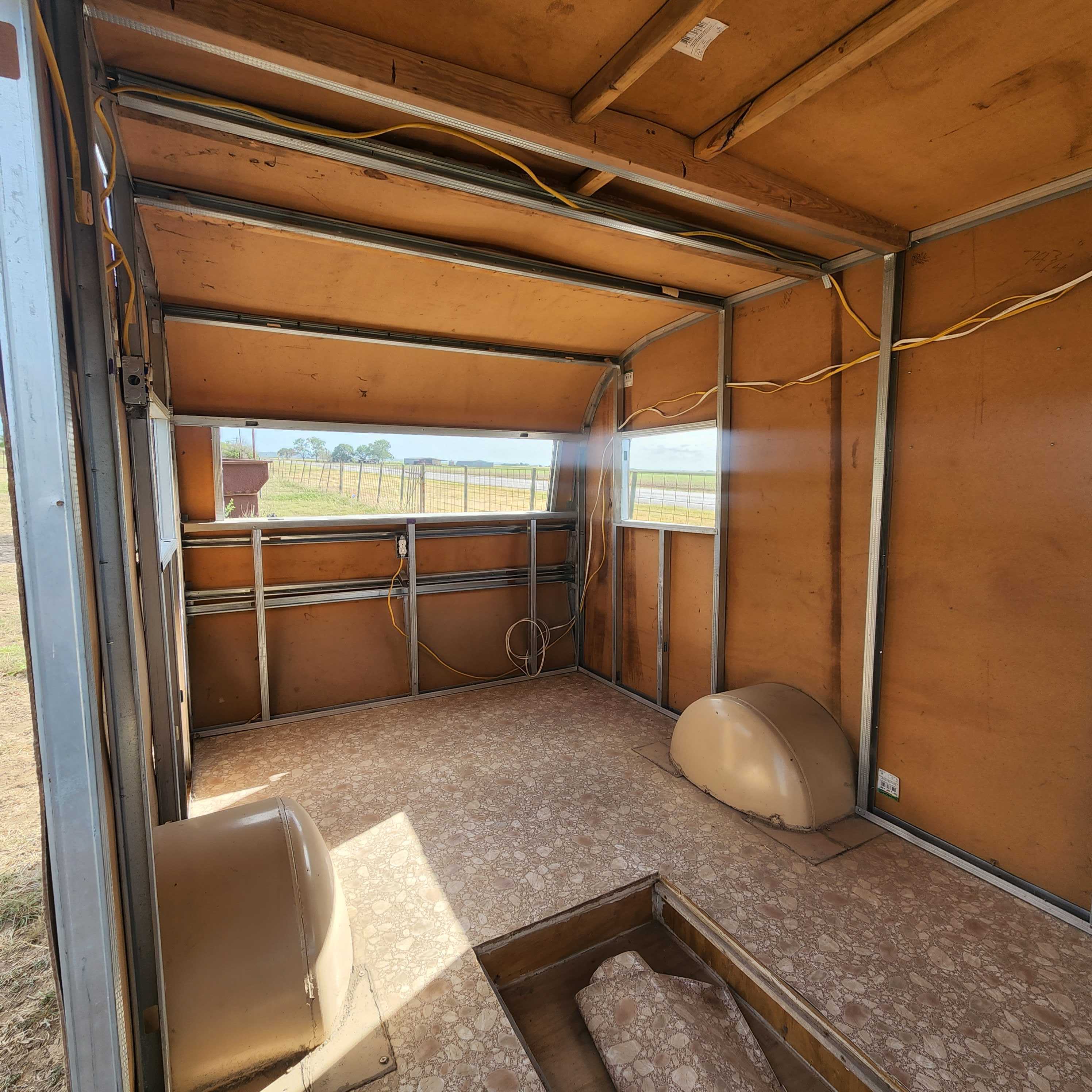

So if I didn't 'skin' it in foam, but just put the foam in between the studs and then coated them in glue/canvas then attached the thin ply to the outside then the aluminum skin to that it might work better according to your reply. I'm attaching a pic of the scotty in it's current state now.

That looks like galvanized steel stud to me. Try a magnet on it.
I guess if you are scraping it all anyway to go taller you could pretty much start over anyway you please.
The thing is, with aluminum skin you need hard edges around the perimeter to fasten at least the trim into (the aluminum can be glued or VHB taped in place long enough to get the trim and other fittings in place... doors, windows, etc). And you don't want moisture getting under the aluminum or trim, regardless of how the inner wall is built; so using PMF under the aluminum seems like extra material, labor and cost to me.
See how your existing ply is buckled even though it is relatively thick material? Don't count on foam being perfectly flat either, but it will be better than that. I am struggling to get epoxy/FG layup to be flat enough for finish paint, so I can imagine how unflat PMF might be, and getting aluminum to lay flat and bond well to an uneven surface seems like a chance for water to get in. In hind sight I sometimes wish I had clad my foam with thin ply before doing the glass layup (in your case aluminum skinning) because I think it would have been easier getting a more fair surface.
But maybe that's not as important to you. If you are going to operate a business and want signage on the sides to look professional, you probably need a pretty flat and fair surface. Just $0.02.
I'll check it out and report back. I have zero plans to scrap it all - my idea is to unscrew the existing frame from the floor and give it a 12" lift (working on the how for that still) then reattach it. should be interesting at least.
