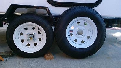

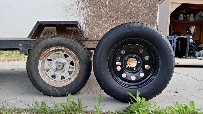

I had always wanted to move up to the 15" wheels from the beginning. I had the 1195# HF trailer which has a light 4 lug axle, 13" was as big a wheel I could get with the correct lug pattern. 15" is a 5 lug. It was in the budget at that time. 2 new tires/wheels and 1 3/4" spacers were under $200.
12 to 13 inch wheels/tires
12 to 13 inch wheels tires s.jpg (39.99 KiB) Viewed 1995 times
As you can see there is a huge difference between the 12" and 13" wheel/tire combos.
13" to 15"
20220619_085634_HDR s.jpg (316.98 KiB) Viewed 1995 times
And the 13" to 15".

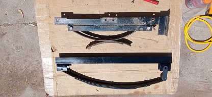

I did flip the short spring on the original pack. It did soften the ride quite a bit. That and only running 15lbs in the tires. After many a bumpy two track the main spring broke right at the center spring pack bolt. That was spring of 2021 so I replaced it with the soft ride springs a guy makes for the HF trailers. The springs are longer and they have actual shackles rather than the slipper style springs that HF and other lower cost trailers use.
springs
20210516_145830 s.jpg (305.48 KiB) Viewed 1995 times
The longer springs make for a softer ride. The shackles make for a nice quiet ride over rough roads. The slipper springs clack a lot.
