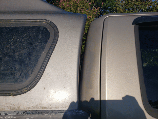

Postby dbhosttexas » Sun Aug 28, 2022 8:43 pm
Okay MAYBE pics will work...
The gap between the cab and the cap is a little funny, but not a big deal.
The cap is definately built for Chevy bed rails instead of Ford, The Ford bed rails are considerably wider... The inside of the rails and the cap flange match up perfectly.
