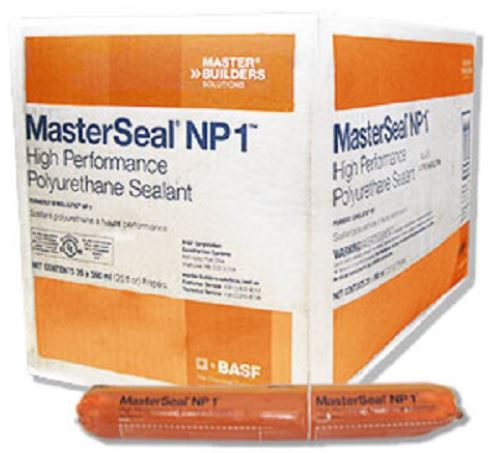

This I have tested fair sized pieces, but cost comes to play.
Racking up; And Rapin foam
