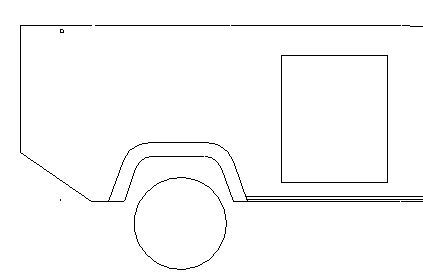

Still have one more line to figure out,
Plan was to figure it out today;
Turned into door, now its hinge, I need two door hinges & a window to draw the doors
Some day I may draw it; but after a few months of attempting another way is "working" :lol:
Got one line on the dirt side Radius (Shown) Only need the correct line on the other side of it. Twice :thinking:

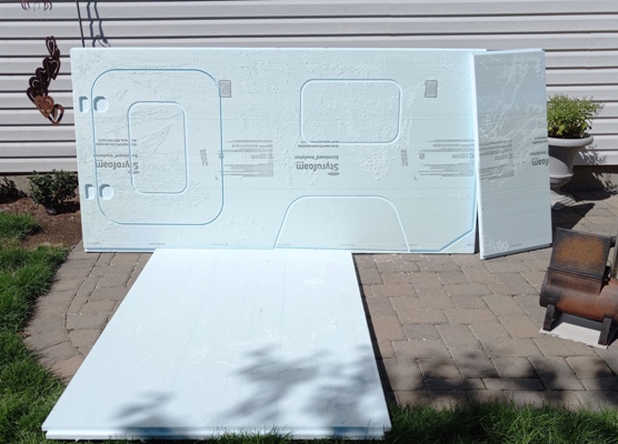

Postby twisted lines » Wed May 03, 2023 8:49 pm
Inside with a little glue & a few Temporary kabob sticks.
havent found / looked for a hinge yet.
Foam 30" x 36 " Door cut out with tab's; then glass in the Right shown side Panel, 1.5" wall & Door.
All on a HF Tool box :)

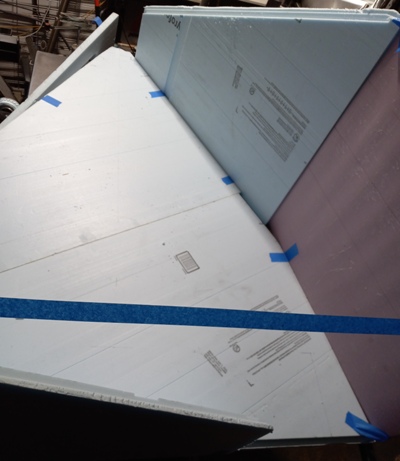

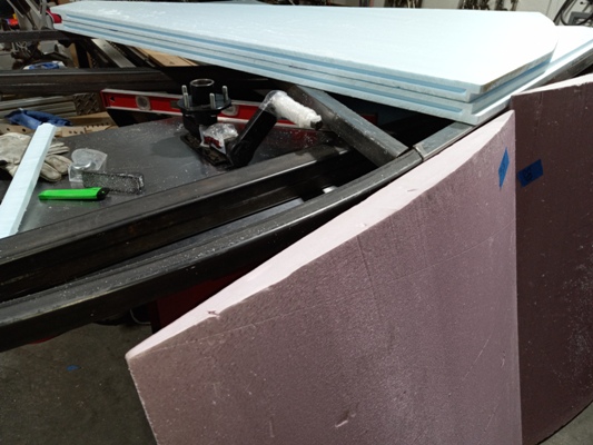

Postby twisted lines » Wed May 10, 2023 2:06 pm

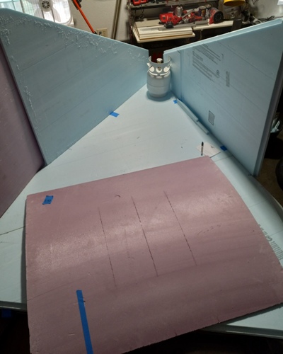

Found a place for the xtra; bottom left holds the wall square.
The piece on the front right has the line I've wondered about but it's, :thinking: Very short for the Top Radi to rest on.
and this is four of 11 piecees just for the front, but its Huge!
My Mini Jack likes it already.

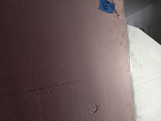

Postby twisted lines » Thu May 18, 2023 5:53 pm

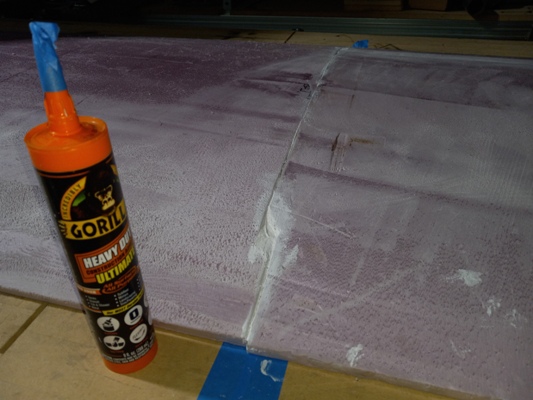

I took the tape off and put the Sika on the Sucka :frightened:
And still don't have the line figured out.

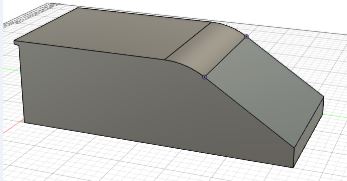

Postby twisted lines » Fri Jul 28, 2023 5:44 am

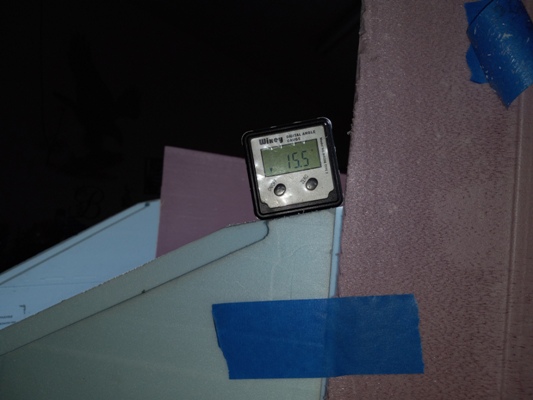

Yesterday's High of 83 was a nice break, for the honey dew's so I moved things around (Cleaned)
And thought I can find that # :thinking: EZ.
Now I just need to cut the tops at that Angle :?
and cut the left side ;)
That Angle.jpg (66.19 KiB) Viewed 3290 times

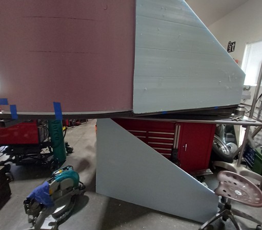

Postby twisted lines » Mon Jul 31, 2023 7:40 pm

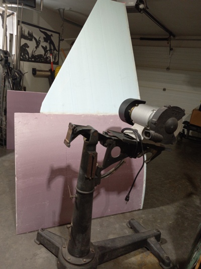

Found this Sewing Machine base; My bride likes it less then my foamie,
Are you sure this will hold you up :x
I think it will adjust to the angle I need ;
And hold the hot wire for a vertical drop :thinking:.
She said find something to do :thumbsup: Then she found what I was Doing :thumbdown:

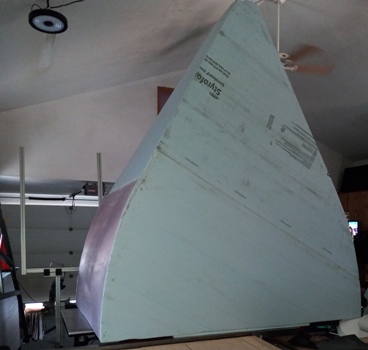

Front nose at 7' is 75" wide.
Front 7'.jpg (45.35 KiB) Viewed 3158 times

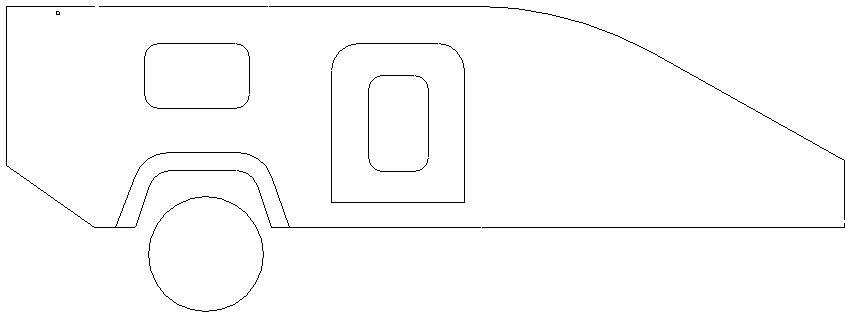

Postby twisted lines » Sun Sep 03, 2023 12:39 pm
Front cut still has me afraid but I am getting close :lol:
Ordered hinge's to draw Holes / Octagon shape Tee Nut Holder's?
Found Window sizes at Teardrop Tech, will size that up shortly,
It was move the Axle forward, Or add to the tail
I still like my Square door bottoms but may change :thinking:
Drivers side.JPG (16.34 KiB) Viewed 2965 times

Postby tony.latham » Sun Sep 03, 2023 1:49 pm
My doors have round corners, so the seals don't have a joint--except the one at the bottom. So I guess it depends on how you're going to seal them.
:thinking:
Re: One more line
Postby twisted lines » Mon Sep 04, 2023 10:54 am
Your doors do look good.
Ill draw 2 more before I cut them.
Thanks Tony.
Dirt side.JPG (24.68 KiB) Viewed 2847 times
