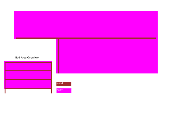

This is what I had planned in a build that I was going to make. Embed wood the full length of the side wall reaching out into the cab overhang. I would also embed a vertical support for this horizontal support near the front lower bulkhead. This would relieve load strains that would centralize in that area and could possibly cause foam compression. Not sure if it would or not, but better safe than sorry. Then you can attach trusses to the horizonal support to support the sleeping area. I would slide the foam from under the trusses just to keep all the wood imbedded. If foam is glued solidly to the trusses, I doubt that you would even have to add any sheet wood to the sleeping area. Should be plenty of support with the foam alone and trusses.
Cab overhang ideas
Camper Overhead Support Ideas s.png (5.9 KiB) Viewed 2669 times
