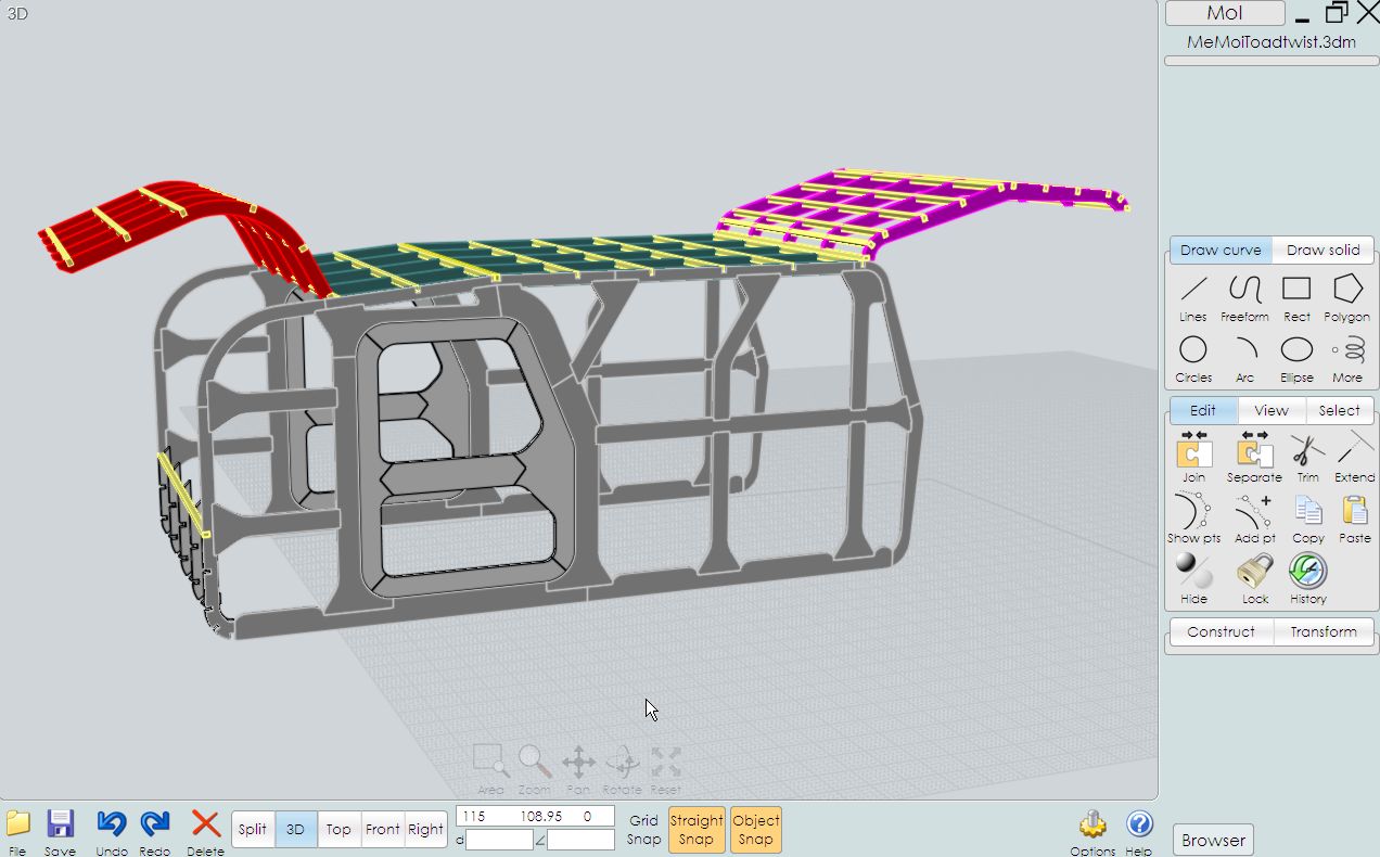

Postby Grummy » Tue Nov 12, 2024 9:19 am
No, "Dogbone" on the primary assembly method, but THEN yes, sandwich.
A method to maximize the use of plywood, rather than just cutting the shape out. The intent was to make a "Flatpack" Kit, that could be shipped on a pallet cheaply via Fastenal, then assembled by others using either or both pocket screws and Biscuits. I posted the concept in a rendering here:

Re: Anyone Spray Titebond ??
Postby tony.latham » Tue Nov 12, 2024 12:22 pm
Interesting. Someone was sure designing for a high snow load and heavy hatches.
