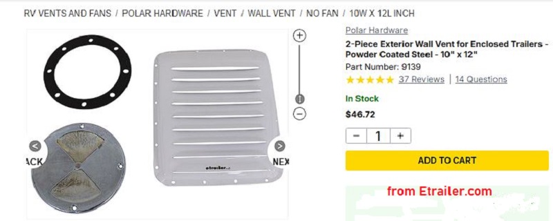

To avoid problem with an overhead vent, I chose to use steel, waterproof, two-piece vents fro etrailer.com, mounted in four places: two for cabin ventilation, one for supplying air to the rear storage area "galley" (and for cooling the interior mouted A/C unit), and the fourth for the exhaust of the A/C unit. I use the galvanized version of this vent
Polar steel vent.JPG (60.06 KiB) Viewed 1057 times
now at $47 each, they were about $20 each IIRC, in 2012
I added bug screen mesh on three of the vents, and leave them partially open at all times, even in the garage at home. The one use for the A/C exhaust is basically a covering for the exhaust duct, and is lifted up when in use. The two vents for the cabin have 120mm Corsair computer case fans (that swing-away, if not needed) that can be switched to either pull air in or push it out, as needed. The vents have proven to be totally waterproof over the last decade+.
