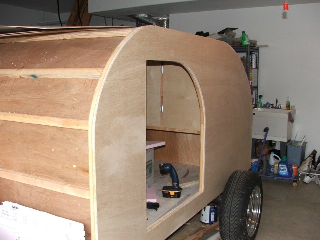

Postby kartvines » Fri Oct 28, 2005 6:48 am
1 sheet of 1/2 plywood
1 sheet of 1/8 laun
1 sheet of 1/8 interior panelling = 3/4"
Image..Image..Image..
Image.
kartvines
Posts: 579
Images: 37
Joined: Sat Jan 15, 2005 12:13 pm
Location: Beaumont, California
