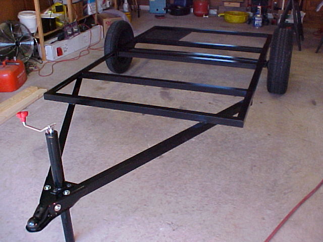

I'm using a combination of both on my frame. I came up with a slightly unorthodox design that will be strong, have good support for the sides and still be completely hidden. The tongue and first two and last X-member will be tubing, with the side rails, tongue braces and any extra X-members being 2X2X1/8" angle. Only my angle side rails will be down and out so if you look at the frame from the end it will look like and L on the sides. This will give me a good surface for spring mounts and I will cut 2X's to sit on the angle and come up to the top of the frame. They get bolted to the angle and the deck will sit right on the frame and these 2X's. No need for a wooden under frame. And this will give the walls support without the frame showing.
I'll try to get a drawing done to make it a little clearer.
This is my current design for my frame
