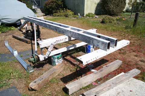

Postby jackdaw » Sat Nov 28, 2009 7:03 am
I've used Al-ko caravan chassis for the first two builds. They have a variable beam, and come with brakes fitted to. They're prity easy to shorten.
This is the first one. The sections are probably a bit bigger than they need to be.
The second one was much lighter than the first, as it came from a little 2 berth Leda caravan built in the late 80's.
The current build is going to have a Trophy caravan chassis . They're a little different to the alko , and don't have the variable beam.

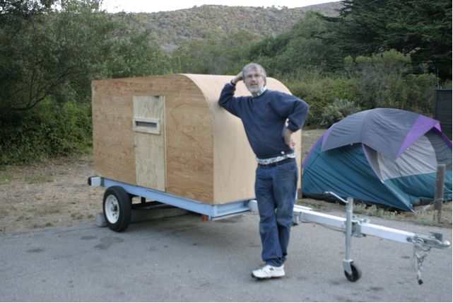

Postby Ron Dickey » Thu Jul 22, 2010 12:17 am
Old boat trailer center beam had to add 2x4's and a part from an aluminum palot that I found across the front for added support.
put on new wheels, tires, tong hitch, and paint
here is what I did to make sides and front more stable.
then rest of body went on that
ending in pictures to your left.
Ron
