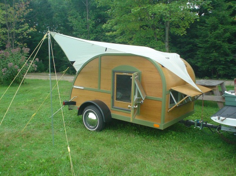

I thought maybe mine were tooo small but nobody is having any trouble getting in or out, most of all me, with the 24"w by 30"h.
Mock something up out of cardboard or scraps to see what you might like........
Image.
Plus having a window in each door and two windows up front seems to make everything feel and look roomier!
Barb
