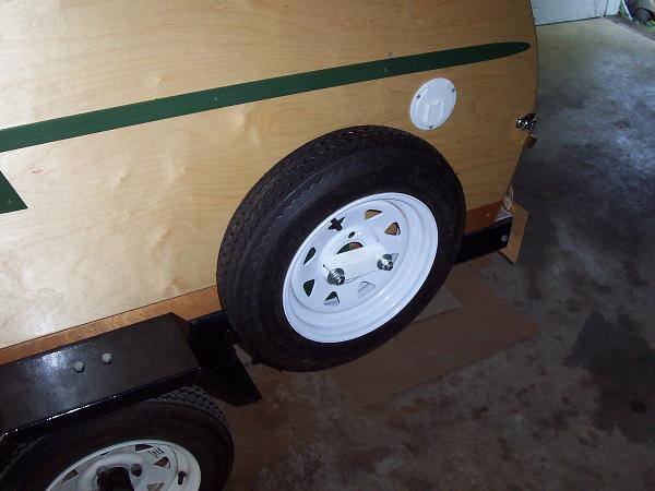

I used to carry mine on the tongue, but I added a tongue box, so I moved it to the left rear side of the tear. It's U-bolted to a piece of 2x4 screwed to one of the stake pockets that came with the trailer frame.
It's pretty solid, and it's easy to get to.
Sam

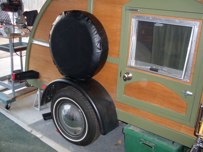

This is on TD #1 at the rear of the tear. It's a junk yard donut spare. I still need to get one for TD #2. It's held to the frame with a "U" bolt that can be padlocked. The lock is just barely visible in this photo. Purchased from Boaters World. Danny
