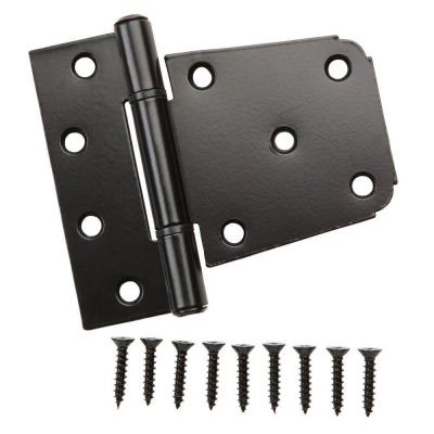

I used gate hinges because they are strong (built to hold heavy gates), durable (nylon bushings and powder-coated), secure (fixed pin design), and black (to match the color scheme). Readily available anywhere (HD, Lowes, TSC, internet, hardware stores, etc.) if ever a replacement is needed.
gate hinge-fixed pin, nylon bushings, powder-coated.jpg (29.84 KiB) Viewed 8393 times

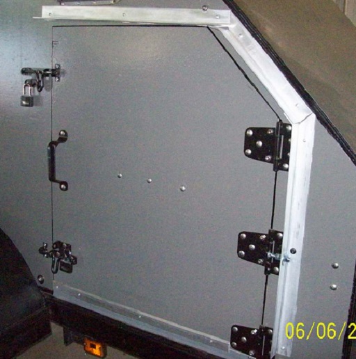

Here is part of a post I made outlining my reasoning for the choice of these heavy-duty hinges :
working on it wrote:... I'm a shadetree mechanic looking to make my own innovations, just to see what'll work and not, function not form. In defense of my solid one-piece doors: If you spread the loads caused by the act of closing/sealing the doors, and waterproof them, then future problems should be nil. Though my cut-out doors are of non-standard shape, I endeavored to spread the loads/forces involved for a tight, even seal all around. I spent some time figuring the most well-distributed loading points before I added the hinges. I did the same figuring the optimal placement for the dual-locks.
triple hinges, dual door locks.jpg (140.73 KiB) Viewed 8393 times
I used three heavy duty gate hinges with nylon bushings, and bolted them on. There will be no sag, considering the light weight of the doors. The slide-locks were chosen for security and to further spread the load. Sealed high and low, the doors are held firmly against the routed interior framework and automotive door-seal. I keep them tightly shut at all times; can't warp if they're held flat!....

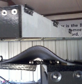

Overkill, yes. But I doubt they'll ever get "loose" or wear out. I even used three more to hang my vertical hatch.
triple hinged hatch.jpg (45.34 KiB) Viewed 8393 times

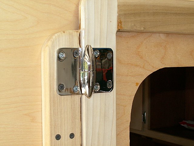

I used chrome plated "topedo" style hinges. The crappy little dry wall screws in the picture were only used for initial fitment of the doors. They are now replaced with stainless steel square drive hardware...so no rust. The hinges allow the doors to be lifted off the TD similar to the way the old Jeep CJ doors worked. I'd definitely do it this way again. I used two hinges per door, although I've also seen it done this way with 3 hinges per door.
Mike
