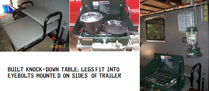

  • I started camping using a knock-down cooking stand that I had built from a junked computer stand, painting it to match the trailer, bolted together with eight 1/4"-20 thumbscrews. Its' legs are secured to the trailer thru large eyebolts protruding from the frame.
    knockdown side table.png (370.39 KiB) Viewed 4993 times
    works fine, secured by eyebolts; two shelves to hold stove and gear

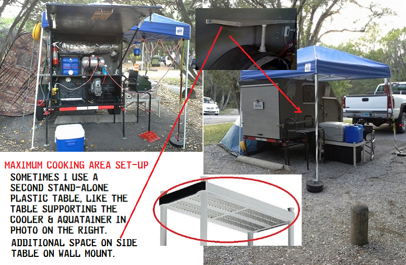

  • On a later trip, I misplaced the thumbscrews, so I used a nearby concrete picnic table as my cookstand, but after being pelted with tree debris from overhead, I decided to make smaller side tables (using T-bolt hardware to slide onto studs on the trailer walls), that required no extra hardware (except for stabilizer posts), which are carried in a canvas bag inside my cabin. I also carry one or two plastic storage shelves (with legs), assembled as a table, or two, to keep my extra cooler off the ground, but also serve as another cooking stand, if I choose to use it. So, I can set up my camping area where I can utilize tables on either or both sides of the trailer (that's why I bought a second canopy, in case I wanted to set up that way), and I get my water from the Aquatainer in the galley, and clean up with the supplies also located there. It turned out to functional well, despite having no dedicated area within the galley for traditional food service, but my trailer is far from traditional, so it suits my needs, as is.
    max setup.png (773.47 KiB) Viewed 4993 times
    cooking stand (2 shelves, mounts on either side), side tables (1 on each side), two plastic shelves as tables = plenty of food prep,cooking, and eating space.
