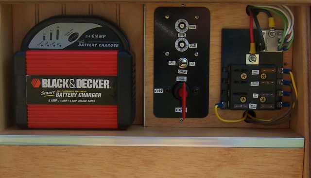

Mike we have 12v outlets/lights/fantastiv fan and 110 outlets for AC and charger...it is a pretty simple system....
...on future models we will probably use the 25A power center pictured in this link;
http://www.bestconverter.com/view_category.asp?cat=63
madjack 8)
