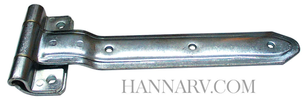

Very similar to yours, it was designed as a toy hauler so the galley is in the front. A couple of observations: The boats don't stay on the trailer for long. The way I've used mine is that the trailer gets parked at the camp site, the boat(s) are transferred to the TV to take them to the lake or river. I only carry boats on the trailer when I am ferrying several boats. In fact, I removed the roof racks a few years ago to repaint and haven't put them back on. I plan to convert mine from a side opening to top opening door. With a top opening door you can throw a tarp over it to make a quick shelter when you want to cook something and it's raining. I had to use special 270 degree hinges so I could swing the door all the way to the side to tie it down. It doesn't take much wind to make it swing around.
this trailer will be used as a hotel on wheels for a while so the canoes will be ontop more so than just to get from point a-b. the top of the trailer will be storage for them if that makes any sense. believe me plenty of people have suggested for the same reasons you are to go with a lift door. I have thought about it and due to the use of the trailer I have come up with that the back door/doors need to be a swing and not lift. I'm starting to lean toward 2 barn door style doors, however. I just need to find good directions to do that. as far as the latch issue Im thinking I will be having the door latch to the pull-out and then a latch system that will drop to the ground if I go with one large one.
In that case, I'd go with a pair of doors. That will be lighter with less stress on the trailer walls. They'll also be narrower which will make them easier swing all the way around to lie flat against the sides. My single door can't lie flat against the side; I have to tie it to the fender which is not ideal.
Here's an example of the type of hinge you'll need.
