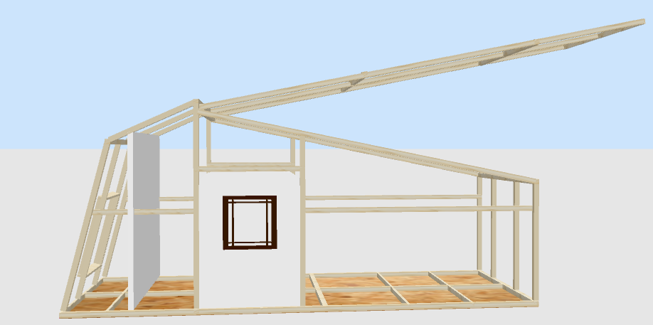

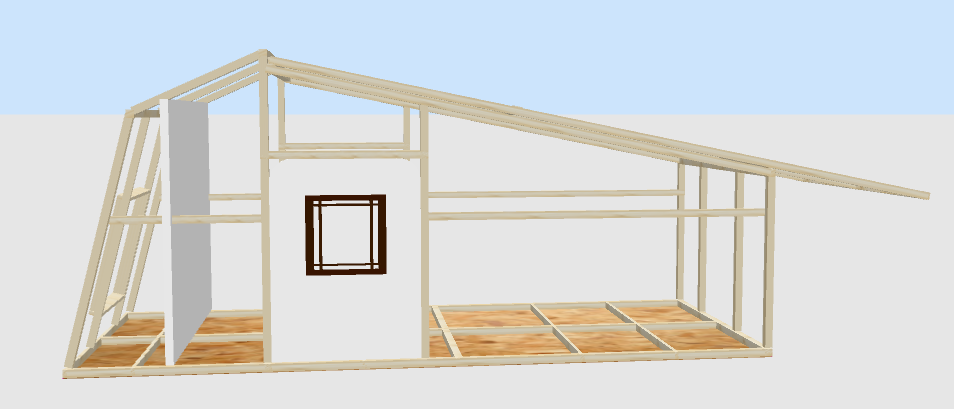

I've had some variation of this design floating around in my head for a long time, but had mostly resigned myself to just having to wait until we have a proper tow vehicle and getting a fiberglass egg. Sadly, that remains the most likely outcome, but I noticed that HF had added a 5x10 to their inventory and my head wouldn't let go of the idea until I had it sketched out. I'm posting it here mostly so I know where to find it later, but I'd be thrilled to chat about it.
open - ~7' tall, ~6' tall at the rear inside
Screenshot 2025-03-23 145637.png (91.84 KiB) Viewed 493 times
closed - 5' tall, 5' wide, 14' long including 1' extra enclosed up front and 3' of open tail in the back
Screenshot 2025-03-23 145606.png (94.88 KiB) Viewed 493 times

Postby publife » Sun Mar 23, 2025 2:41 pm
The design is mostly 2x2 and 1x2 boards and XPS foam. The front area would be for the generator, gas, and whatever cargo makes sense to get the balance right. The depth of the cargo bay, the door placement, and the peak height point are all still up in the air - I haven't seen the trailer in the flesh, this is just my best guess based on HF's product info. The tallest portion of the back side panel will be 48" high no matter what, and I need the rear of the trailer to be at least 33" closed and 72" open. I've got 35.5" closed and 73.5" open right now with my guesswork, so I think I'll be able to stick to these angles even if I have to move the doors and the peak a bit.

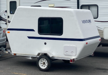

On the sides, I'd use 1.5" XPS between the framing, with a layer of .75" XPS inside with the horizontal 1x2s, for a total of 2.25" foam and an interior width of 55.5" - which fits our full size trifold mattress with the tiniest bit of breathing room on the sides. The doors are the 28" x 38" models that are widely available on ebay/Amazon. The front and rear panels would be 3" of XPS foam on the exterior, plus the 1.5" between the 2x2s. The goal here is to have lots of room for the sweet radiused corner look I saw on facebook forever ago:
credit to Johnny Sea in the Homemade Campers group on facebook
Screenshot 2025-03-23 153828.png (131.15 KiB) Viewed 491 times
