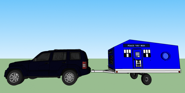

OK - DH & I discussed many lovely classic trailer designs. We have agreed upon a pretty simple design that looks like Dr Who's Time machine. That's pretty much how things go around here. :roll:
Anyway, it will be a 6' x 10' Foamie, built on an aluminum chassis & we're working on ways to make it sturdy, waterproof and collapsible. Should be interesting.
Here's my attempt at Sketchup. The Tardis details will be paint & automotive decals, rather than structural.
The chassis shown here is a snowmobile trailer, which is one of our possibilities.
After the 1st, we'll get the tow hitch for the Jeep, buy our chassis and get started. Wish us luck - we'll need it.
Gettin' my geek on,
Andrea

With a teardrop One shows it very often. With a Dr Who theme you will be very poplar!
If you plan on long trips you might want to radius or taper the back for easier towing.
PS, I think the smallest TD as Tartis'es because when you lie down in one is seams a lot bigger then on the outside.
I THINK I understand what you mean by that, but would love an example to be sure. It's probably a good idea.
DH & I are trying to come up with a workable compromise. I'm kind of a minimalist & like the smaller, more aerodynamic profiles. DH wants LOTS of room. He's 6'2" & a reluctant camper, so I need to compromise on that. I suppose it would be better to wind up with too much room than too little, in any case. But I'd still like to make it as easy to tow as possible.

Postby KennethW » Sun Dec 07, 2014 7:16 am
Abaker50 wrote:If you plan on long trips you might want to radius or taper the back for easier towing.
This is a shape that may allow a smother air flow and max room.
125859click to inlarge
It is the roof and back shape that would allow air to flow over the trailer easier.
But some say a flat back does not hurt the mpgs that much. I just like the more round shape.
PS: The curves is not as hart as they look and add a lot of strength .

Postby rowerwet » Sun Dec 07, 2014 1:50 pm
The shape doesn't matter much behind the tallest part of the roof, the front does matter a ton, that is the end that needs to be rounded, especially if you are building a tear wider than the car.

Postby S. Heisley » Sun Dec 07, 2014 8:59 pm
If it is rounded, it will look even less like a Tardis. :(

S. Heisley wrote:If it is rounded, it will look even less like a Tardis. :(
That's true & DH is dead-set against rounding it off, anyway.
He's waffling again, so we'll see. :roll:

Here's an idea.... if you want it to look like the actual tardis why not make it as if the tardis is on its side like it's fallen over.
That way the tardis roof is more streamlined and you could make it more in proportion....just thinking
