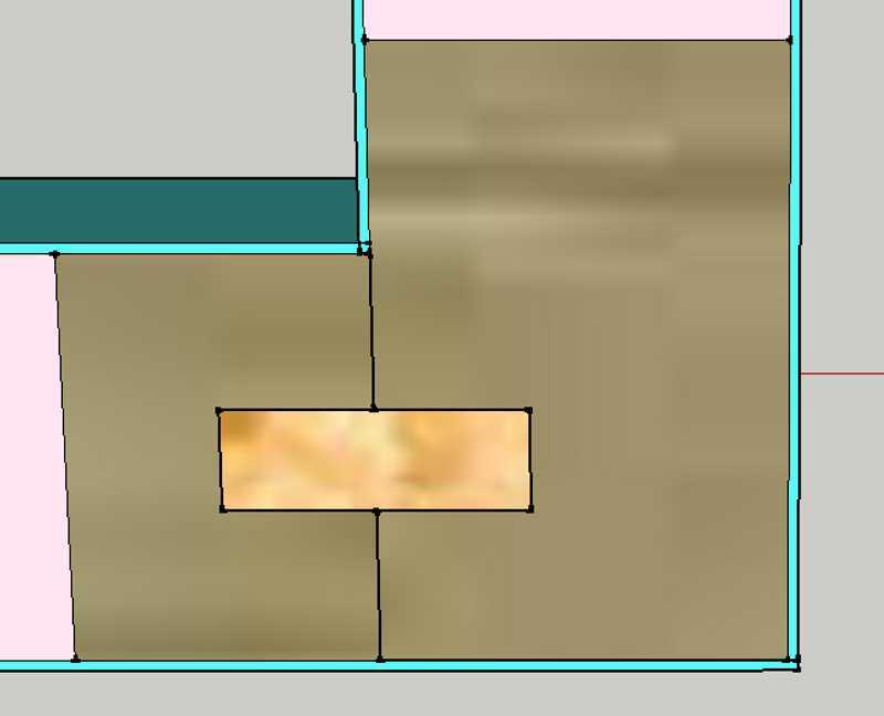

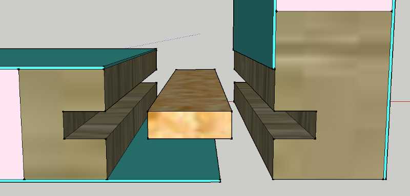

Tongue and grove attachment of 2 SIP panels. The tan piece is a strip of wood that keys into a grove in both panels. It provides extra gluing area to increase the strength of the joint, and also makes the joint have multiple planes. That means when one is in shear loading, another is in compression or tension loading. That allows the glue in compression or tension to support the glue in shear. Notice the face material is oversized on one panel so it can cover the edge of the other panel. If the face material is aluminum, then it is possible to bend it over and edge and have the surfaces glued together for a water tight seal. I'd use that for the roof joints.
SIP to SIP panel joint parts
Detail showing the parts all mated together.
