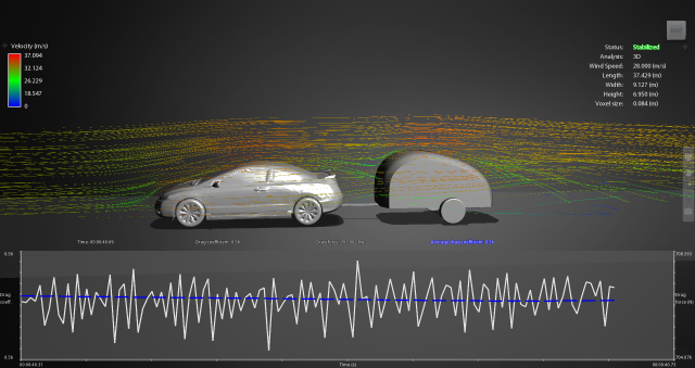

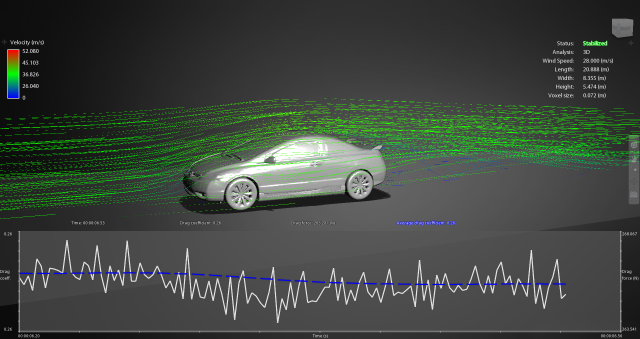

You may find my wind tunnel (CFD) simulations interesting. I've done a couple different situations with my car (2010 Honda Civic Coupe) towing various shapes of trailers.
Just Car
Drag = 270 N
With 5x8 Enclosed Trailer
Drag = 820 N (3x Car Drag)
With Normal Teardrop Trailer
Drag = 710 N (2.6x Car Drag)
So according to my math, my car would go from about 38 MPG to about 17 MPG pulling a normal teardrop, and it would drop to about 15 MPG pulling the 5x8 enclosed trailer.
I'm not sure exactly what decrease in range you would see pulling the shape you've proposed but I'm guessing it would be a pretty significant decrease. Probably not half like I would see with my car though.
There are a bunch of things you can do to make a design more aerodynamic.
- Reduce the gap between the vehicle and trailer
- And wheel fairings in front of and behind the wheels (Google wheel pants)
- Add a boat tail
- Lower the roof of the trailer
- Round all exterior corners
Here's a sneak peak of the trailer design I'm working on right now, so far it's much more aerodynamic than the normal teardrop shape while maintaining about the same amount of internal room.
The air splitter on the front takes care of the turbulent air between the car and the trailer. I still need to add wheel fairings but other than that this is a pretty aerodynamic trailer.

timm wrote:You may find my wind tunnel (CFD) simulations interesting. I've done a couple different situations with my car (2010 Honda Civic Coupe) towing various shapes of trailers.
Just Car
Drag = 270 N
- Add a boat tail
your calculations are way off for MPG losses.
Aerodynamic drag is a function of speed as well. And for MPG the loss is a variable of the speed. But that's only a portion of determined MPG. The weight of the vehicle, load weight, trailer weight etc all effect that.
My CRV only lost about 15% at 55mph towing something 1500lbs , some front angles and square back. Your not going to loose half your fuel mileage because of a large increase in aerodynamic resistance.
Sent from my SM-G950U using Tapatalk

Postby timm » Mon Oct 29, 2018 8:43 pm
You are correct that fuel mileage is dependant on multiple things, however, my calculations have taken pretty much everything into account. Of course, I can't say for sure that my math is perfect without building the trailer and doing testing.
I calculated the mileage losses at 62 mph, which means your 15% decrease in mileage would probably be closer to 20%. You also have to consider that a CRV has a larger engine than a Civic so it will tow a trailer easier. Considering aerodynamic drag and rolling resistance are basically the 2 major things contributing to fuel mileage it doesn't seem crazy that tripling the aerodynamic drag and multiplying rolling resistance by 1.5 would reduce mileage by half.

Postby Tigris99 » Tue Oct 30, 2018 4:08 pm
timm wrote:You are correct that fuel mileage is dependant on multiple things, however, my calculations have taken pretty much everything into account. Of course, I can't say for sure that my math is perfect without building the trailer and doing testing.
yes it has a slightly larger 4cyl but is 4wd and a much larger profile.
Your images show that you actually tested on not actual teardrop (partially flat front) which is a problem for cars. You percentages seem more in line than the way I read the first post of about 50% loss in fuel mileage.
I know a guy who towed one that was production squaredrop (horrible profile) with a Suburu and his losses werent as bad as one would expect combined with 1500lbs of trailer.
Now my old trailer fully load plus stuff in the back and full family in our odyssey the faster we went the better the mileage. 55-60mph loss wasnt bad, got better mpg at 70mph. 4000lb minivan with 2 adults, 2 kids, cooler and gear plus 1500lb trailer. My wifes van is way over powered along with 8speed tranmission for a minivan. Trailer was built flat back but to stay in the draft of the van as much as possible.
Biggest concern with cars is and flat nose space. Getting all crazy is cool (love the lines I'm seeing of going full aerodynamic around here) but weight and eliminating square surfaces front and rear seems to make a huge difference.
Try simply wedging the nose so leading edges stay in cars draft and see how much of a difference that makes compared to benroy/canned ham styles. Or even true teardrop.
Keep in mind that a with a civic weight is going to play as much of a role as aerodynamic drag because unless you live where it's perfectly flat hills are going to be a big issue, even a small grade is going to make it strain alot if you try to push is max rating. and that rating INCLUDES all weight in the vehicle minus the driver and tank of fuel.
Just thoughts of keeping it simple and cost effective versus trying to make a bullet on wheels. But that of course depends on your time and funds.
