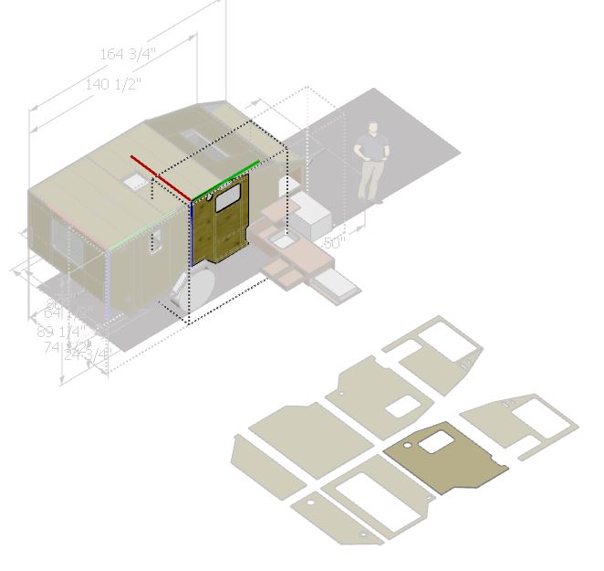

2017 sketch, hope it helps :)
trailer_frame3.skp
(4.07 MiB) Downloaded 143 times

Looking good so far!
When you are ready to fine-tune your design you might find it helpful to break all of the parts into separate components. You can then lay them all out and get them ready for CNC milling!

I do the same as eLink. And even with out CNC, you can draw 4x8 plywood component and layout it out underneath the components on the ground. Makes it easy to plan material usage and cut order.
