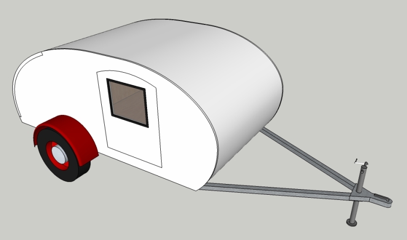

Postby danlott » Wed Mar 07, 2012 3:03 am
Here is a Grumman style teardrop model I just finished in SketchUP for the insturctional video series.
http://www.tnttt.com/viewtopic.php?f=62&t=49233
Grumman 2 Teardrop.skp
(1.88 MiB) Downloaded 1583 times
Dan

Re: Grumman Style Teardrop
Postby danlott » Fri May 25, 2012 6:10 pm
The Grumman II sketchup file is posted above. All you have to do is download it and then open it in Sketchup 8. You can make it as wide as you like, but you will have to make sure the frame and axle are the right width for what you are building. I do not have any measurements outside of what is listed on Andrew's website located above in the Design Resources. You can also get measurements off the sketchup file. This is the link to Andrew's Grumman II design that I copied to make the sketchup file.
http://www.angib.pwp.blueyonder.co.uk/teardrop/tear55.htm
Andrew's drawings do have the frame layout and dimensions that you can use to determine the axle size. If you want to make it wider than you will need to do the math to figure out the size you need.

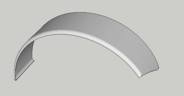

Postby Vindi_andy » Thu Jan 17, 2013 7:27 am
Dan please can you help me.
I am trying to create fenders similar to the ones one have on your model but with an angled leading edge so they mirror the TV but sketchup wont let me fill or pull the object i have made. It seems it doesnt like objects that have angles in 2 planes

Postby danlott » Fri Jan 18, 2013 12:19 am
I think I have an idea what you are talking about. If you could post a paper drawing of what you are trying to do I think I could help. Just not 100% what you are trying to do.
Dan
Hoplite Traveler Build thread
danlott
Posts: 874
Images: 264
Location: Winnemucca, Nevada
Postby danlott » Sun Jan 20, 2013 1:05 am
I looked at your photo album and seen your tow vehicle fenders. I believe I understand what you are wanting. I made a quick sample and will post a picture. It takes a little work to create it, but not to bad. I can try to explain it if you want, but will do it over a private message as it is fairly long.

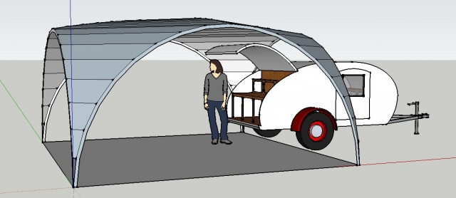

Postby Vindi_andy » Thu Mar 21, 2013 7:44 am
Been playing around with Dans Grumman profile and a Coleman event shelter as This is what I have just bought and thought people might like to see how it fits
Here's a download link I hope it works
http://sketchup.google.com:80/3dwarehouse/download?mid=fa86c3d1790a50bd752d871d0a8cc9a8&rtyp=s8&fn=Teardrop+in+Shelter&ctyp=sm&ts=1363869294000
