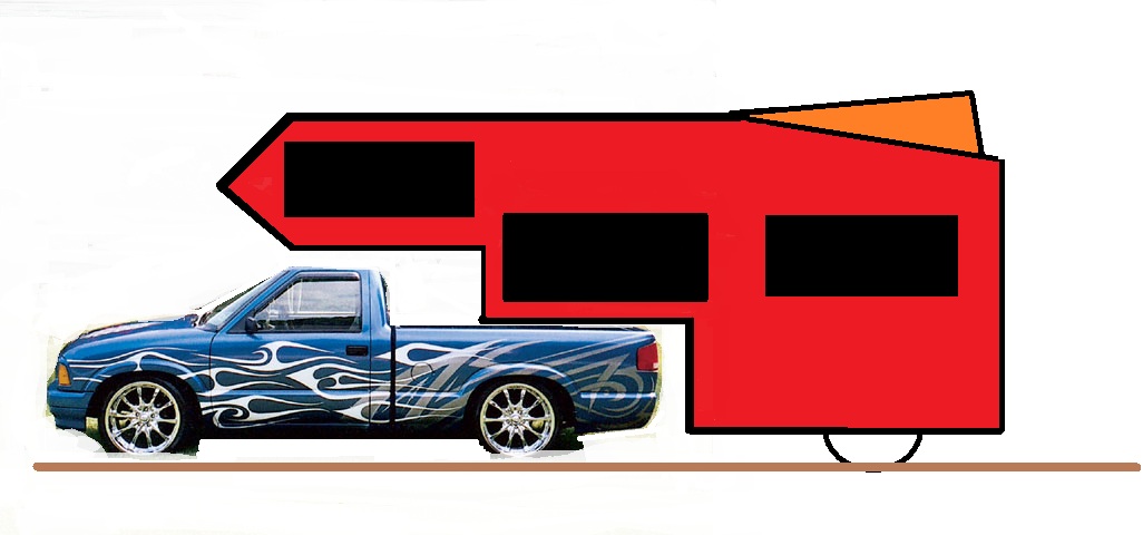

OK so i have been lurking on the site for awhile and have been coming up with ideas on what kind of camper would best suit my needs
i have decided that a 5th wheel layout will be the best for me
here is my design i threw together with ms paint please don't laugh its my first time using it
any feed back would be greatly appreciated and any sketch up gurus that know how to shrink sketch up files to the required size
if you can tell me how i have a couple more designs i did in sketchup to show you guys

I like your thinking, but you'll need more clearance over the cab of the truck if you want to drive anywhere not perfectly flat.
It might be an aerodynamic nightmare having such a space between the two, but it needs to be done to avoid disaster.

First off, I am not an Engineer. But I have seen them on Television. I like your idea, but my concern would be the weight of your project. If you are pulling with an S-10 you may exceed the safe limit of it's towing ability. If it was my project I may eliminate the part over the cab. That is just me. If you are able to figure the expected finished weight it may answer these questions. Also that is a lot of area on the sides to catch wind. Good luck with your project and keep us informed!

The weight issue might be overcome by going with foamie construction.

its just a rough sketch to get an idea of how it looks ill work on dimensions and clearance when i have sparks flying its going to be a lightweight build using a 1"square tube exo skeleton i have a couple of old full size truck ladder racks that i will be using for the frame of the body still in the planing stages but once i can find out how to shrink sketch up files i can show you some pictures in more detail my files are like 2200 kbs it wont let me upload them to the page for some reason the s10 is a strong lil beast 4.3 l vortech with a 5 speed its the same engine used in 1/2 ton pickups :twisted: i figure i can add a small 1 ton rear end out of a Toyota to it if it needs it
the upper part over the cap is the bed so i cant realy take it off the section over the bed of the truck is the kids room and the lower part wil be galley /head eating dining

You can downsize your SketchUp files considerably by going to the "Windows" tab in SketchUp - click on "Model Info" - click on "Statistics" - click on "Purge Unused" then click on "Fix Problems".
That should clear out all the unused stuff in your SketchUp files.

in regards to the weight issue what if you went with a tandem axle

again i don't think weight will be an issue my truck is rated for towing 5000 lbs with a 1500 max weight in the bed

this truck tows my 18 ft lund adventurer wit a tandem axle trailer like nobody's business its a 1/2 ton pickup in a compact package

just for good measure, look around on line for a 21' or a 22' shadowcruiser brand 5'er. I had a 27' at one time, but that's a bit too heavy for your little S-truck.
I towed a unit similar to this one with an F150 with a 5.7l v8. On another forum I frequent they always say 'getting it moving isn't the issue, getting it to stop Is...'

Have you looked up "Scamp" fifth wheels. They are little fiberglass ones made for towing behind s-10's and rangers and other compact pickups. They look pretty roomy too. More just like a travel trailer with a little extension. Might be able to use it for some inspiration.
