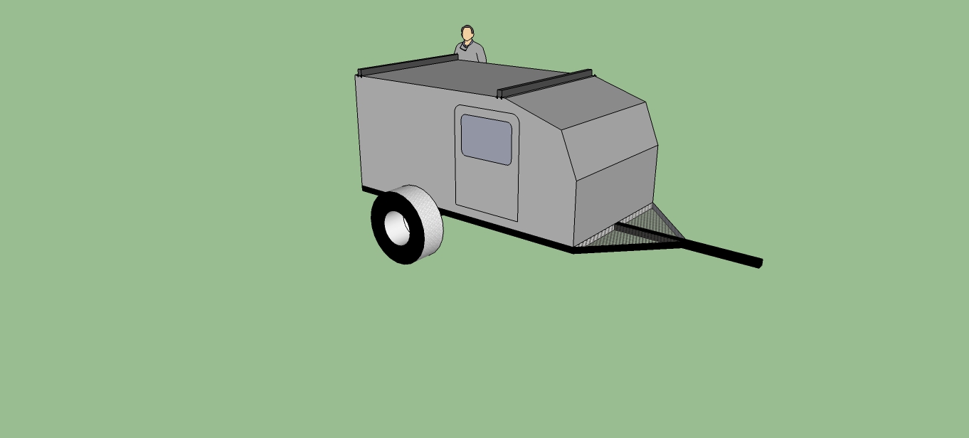

Postby lilgription » Mon Aug 19, 2013 10:12 pm
Here is the design I'm gathering parts for. Flat back Galley for simplicity

Re: Not really a new design but its the one I'm going with
Postby angib » Tue Aug 20, 2013 7:44 am
Remember that the flat back galley looks simple, but you end up with the back end of the roof just where your forehead (or teeth) wants to be when you're using the galley. Plus you need to leave enough clear height from the worktop that a stove won't set fire to the roof.
A cranked galley 'hatch' that's vertical below the worktop and gently raked forwards above the worktop is maybe the easiest 'hatch' that doesn't have these problems.
Postby lilgription » Tue Aug 20, 2013 11:18 am
angib wrote:Remember that the flat back galley looks simple, but you end up with the back end of the roof just where your forehead (or teeth) wants to be when you're using the galley. Plus you need to leave enough clear height from the worktop that a stove won't set fire to the roof.
I will keep those suggestions in mind. This tear will be sitting on 31" tires. So the roof will be just over 6' tall and if I raise the galley hatch higher than that I think I will be OK
Postby working on it » Sat Aug 24, 2013 3:55 pm
I also wanted a flat galley hatch for simplicity; though my "galley" is more a storage compartment for Coleman stuff, gasoline, generator, and A/C w/ducting, than a conventional galley,110132 still, it will serve as a shelter from the elements while using the cooking stand set up on the trailer side. Utilizing the hatch as a sun/rain deflector is the reason why I didn't make it a split side-opening door set (my first thought). The hatch itself raises up over 6'6" (at the end) to 6' (trailer roof height) when the prop rods are installed (and screwed tight to prevent wind lift-off),102796 and the gap between the hatch and roof is sealed with treated conveyor belting.....102809 I'm 5'11", so it suits my needs as a shelter. I do like ksmack01's door storage racks...but my trailer is already overweight without it....
Postby lilgription » Sat Aug 24, 2013 9:25 pm
working on it wrote:
I would never have thought of using conveyor belt like that. I'll keep that in mind
