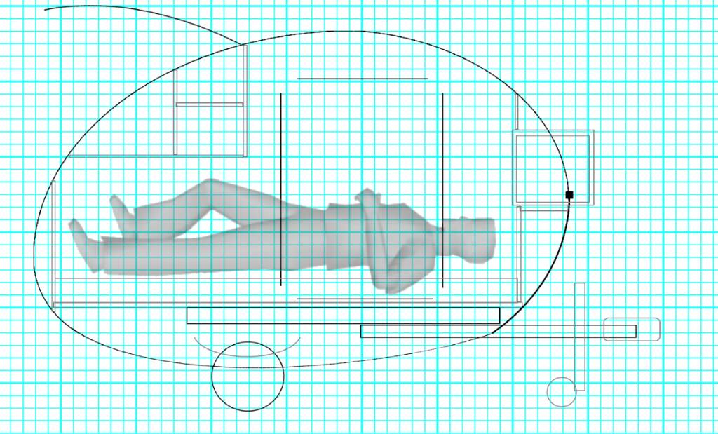

tonyj, that's just what I'm after. I want to build a simple sleeping shell this winter, and get out there in the spring... ! Using the tool, here's the profile I've got so far:
112550

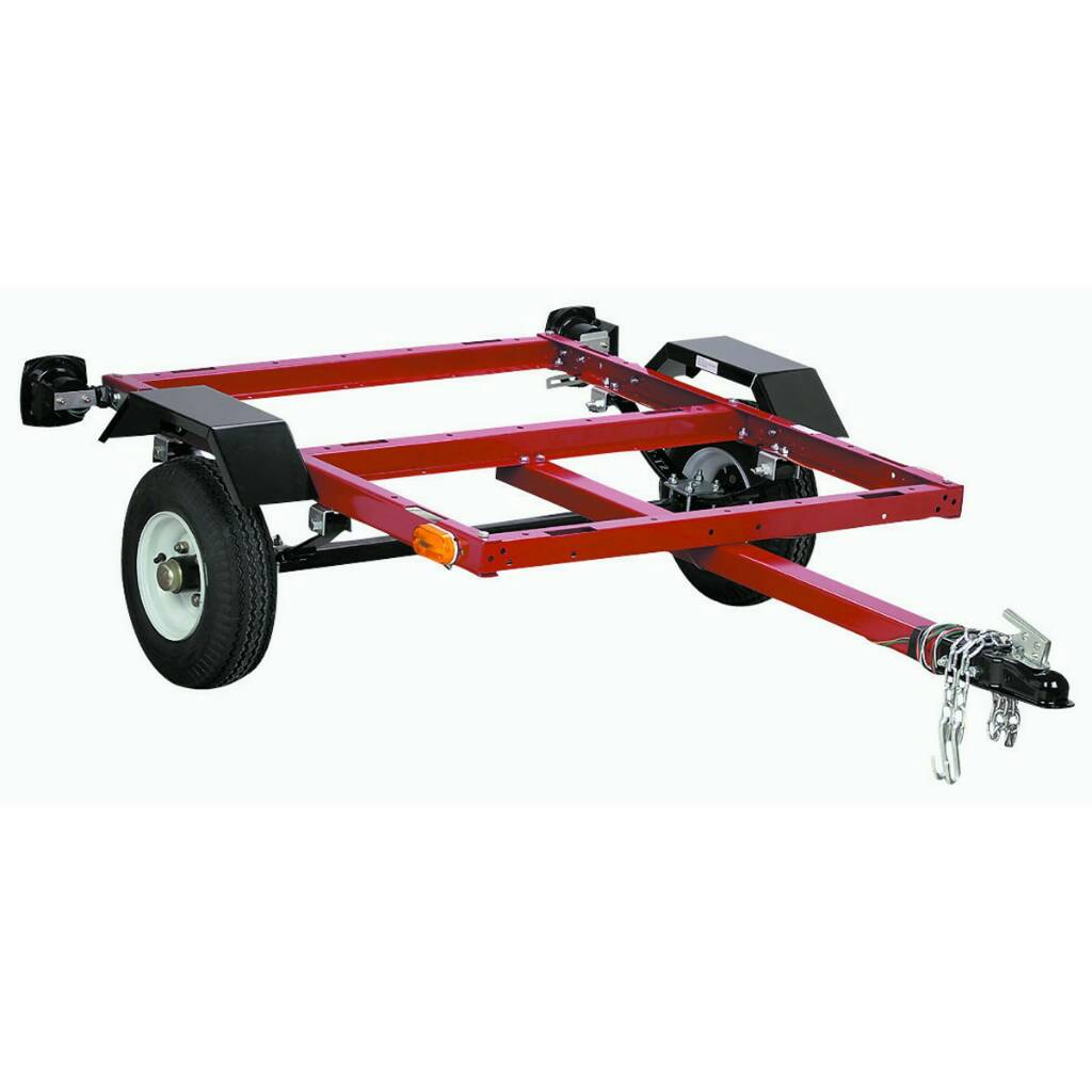

Three circles, one ellipse for a profile that will fit a 4x6 floor that will bolt onto a 40"x48" HF mini-trailer. I am struggling with keeping it Simple; reading all the good info here gets me thinking ambitiously... :D

A quick mockup using the profile tool you created.
MrMatt
Posts: 66
Joined: Fri Jan 19, 2007 6:20 pm
Location: Colorado Springs CO
Re: profiletool: Way too much time on my hands...
Postby MrMatt » Thu Oct 31, 2013 3:03 pm
I used your tool for the curve then some other tools for everything else.

Postby Glenn Butcher » Thu Oct 31, 2013 9:27 pm
MrMatt: Very nice! What other tool did you use?
I did some munging of the one on pulpitrock.net, displayed a picture underlay of a trailer whose profile I liked, added the angle extents of the ellipses to the input boxes, and made another ellipse modifier, so now:
    Drag: moves the selected extent, the opposite one stays still
    Shift-Drag: all four extents move; if it's a circle, the radius changes
    Ctrl-Drag: moves the selected extent and the opposite one;
The pic overlay would be hard to make 'friendly', but the angle extent inputs and the drag modifiers are ready for prime time; I'll try to move them up to the website this weekend
I've used the tool to produce two candidate profiles. I'll start my build thread soon, and put them up for comment. I also have a skylight idea...
