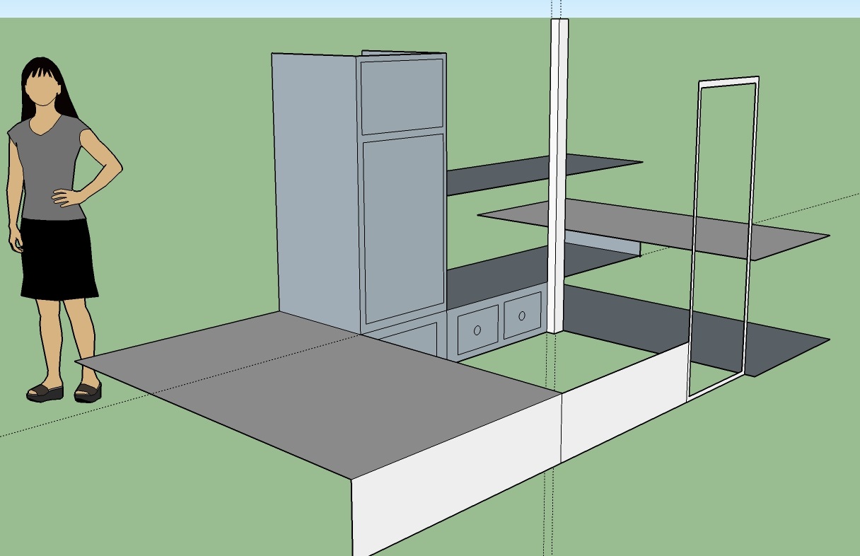

Postby nater104 » Tue Aug 26, 2014 10:35 am
Dreaming up a future rebuild of our 1966 Scotty Gaucho where we have staggered bunks to fit our four kids. Basically a tiny bunk house. Next to the entrance door is the kitchen area, possibly sliding out an access panel to be used on the outside and just have a high bench inside or more storage. They would only have about a foot over their feet teardrop style. The bottom side bunk especially would be short on upper body space since the front bed is 35" wide like the current dinette. Side bunks only 24" x 6ft. In my dreams that is a decent sized 2/3-way fridge between the big bed and the bunks.

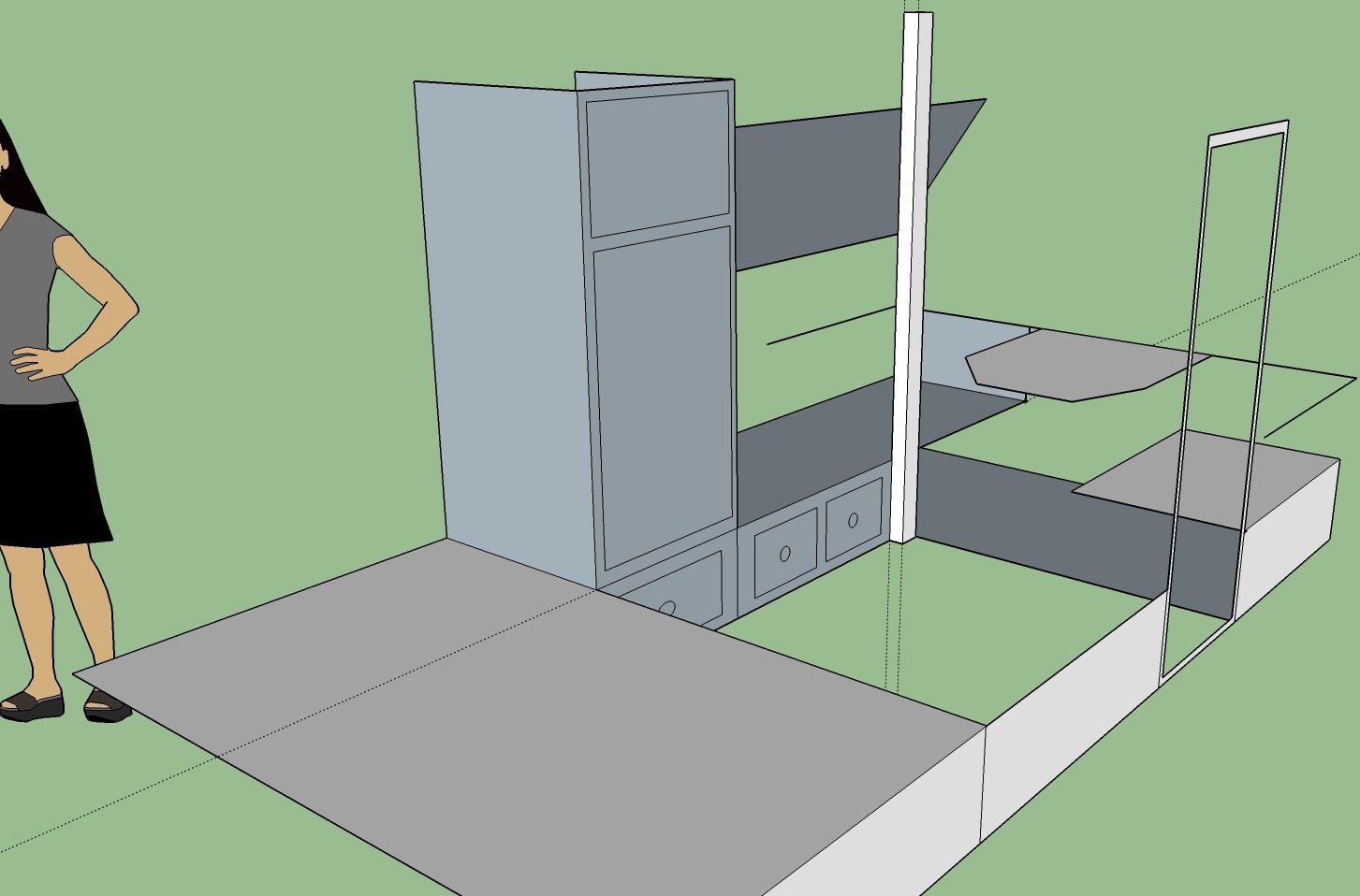

Postby nater104 » Tue Aug 26, 2014 10:58 am
And the top side bunk would tip up like a lot of campers' bunks do. The front upper bunk would be three pieces. The center is the current table. The sides are removable so that the right side can be lowered to be used as a bench with just another layer or side/back supports to rest on and the other side put out of the way some where and you would sit on the lower side bunk.

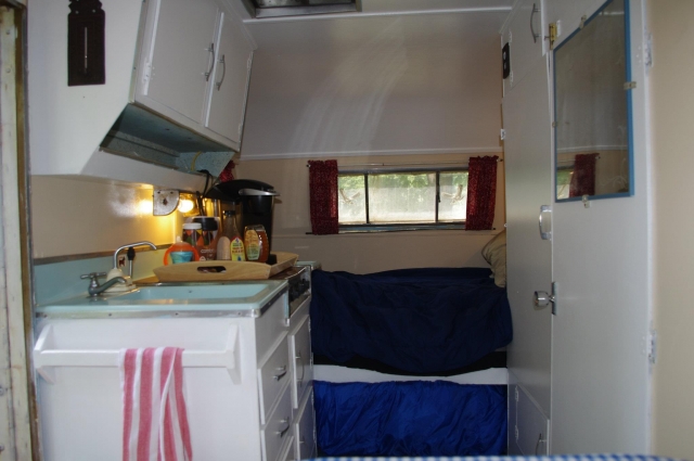

Postby nater104 » Tue Aug 26, 2014 4:55 pm
Currently looks like this except the ceiling leaked again around the vent and messed the new paneling up.

Postby tawright915 » Wed Jan 27, 2016 6:29 pm
nater104 wrote:Currently looks like this except the ceiling leaked again around the vent and messed the new paneling up.
Can I ask how wide this is.

Postby nater104 » Wed Jun 06, 2018 11:10 pm
75” wide I believe. Still sitting under a tarp in my yard. Haha
