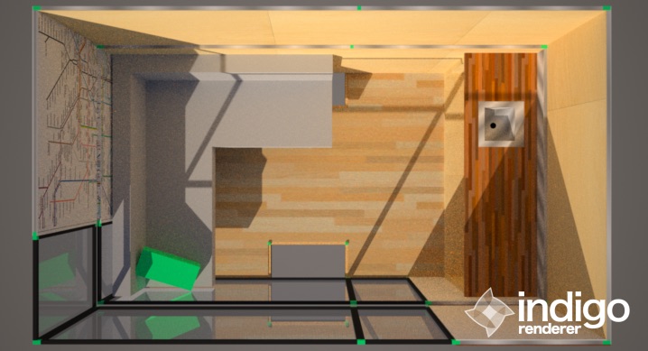

I've been toying with designs for a hard walled popup with minimalistic architecture for some time. I like the idea of a camper with a view for scenic sites.
I have the donor trailer (an old tent camper trailer) and I've begun sketching designs on top of the trailer dimensions.

Nice renderings. :thumbsup:
Welcome to the forums.
Any thoughts on methods and materials of construction, and specifics on how you will seal the upper and lower halves together? :thinking:

Postby icematrix » Tue Feb 10, 2015 7:00 pm
Thanks :)
I plan on using aluminum square tube for the framing. The walls will be skinned with aluminum on the outside, then a layer of foam. On the inside the materials vary from hardwood ply to sheet metal. I will probably use VHB tape and construction adhesive wherever visible to avoid lots of fastener holes.
I will use guides at the corners to keep the halves in line, and front and rear linear actuators coordinated by a microcontroller to do the actual task of raising and lowering.
There will probably be some sort of stiff brush material or a rubber gasket in the gap between halves to keep nature out. I need to do some more research on that.
I plan to use this for spring and summer camping only, and keep it garaged in the winter.

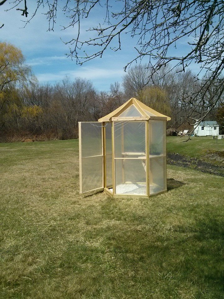

Hexagonal Greenhouse

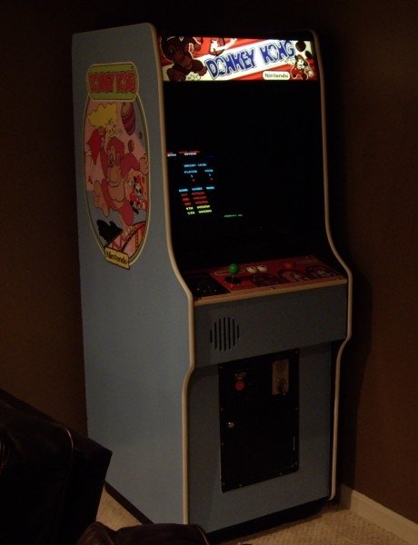

Donkey Kong

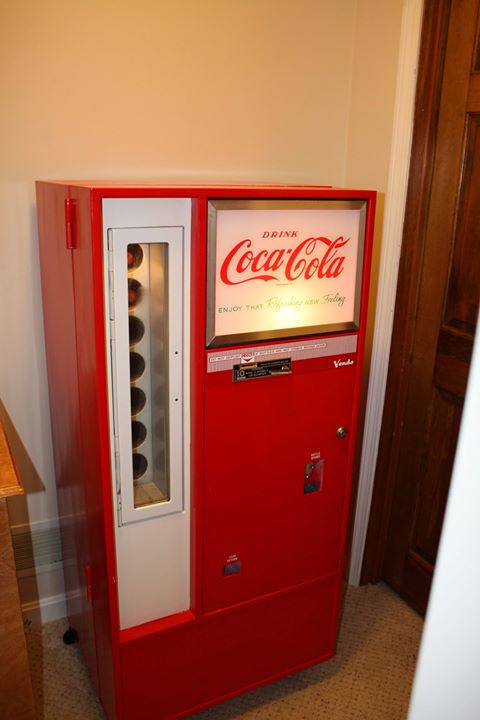

60's Vendo Coke Machine

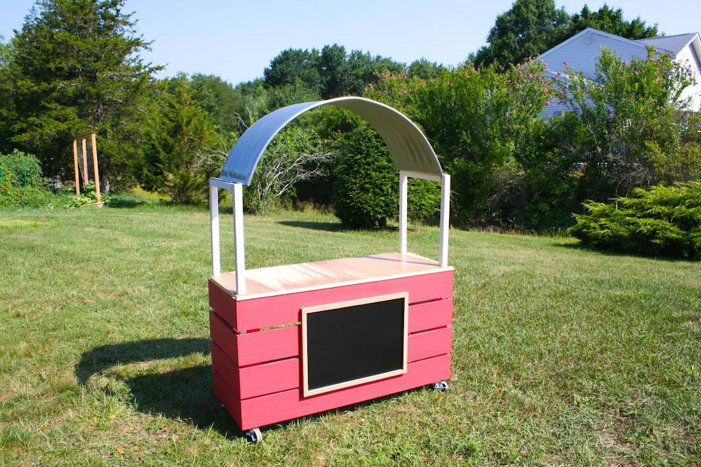

Lemonade Stand for my kids

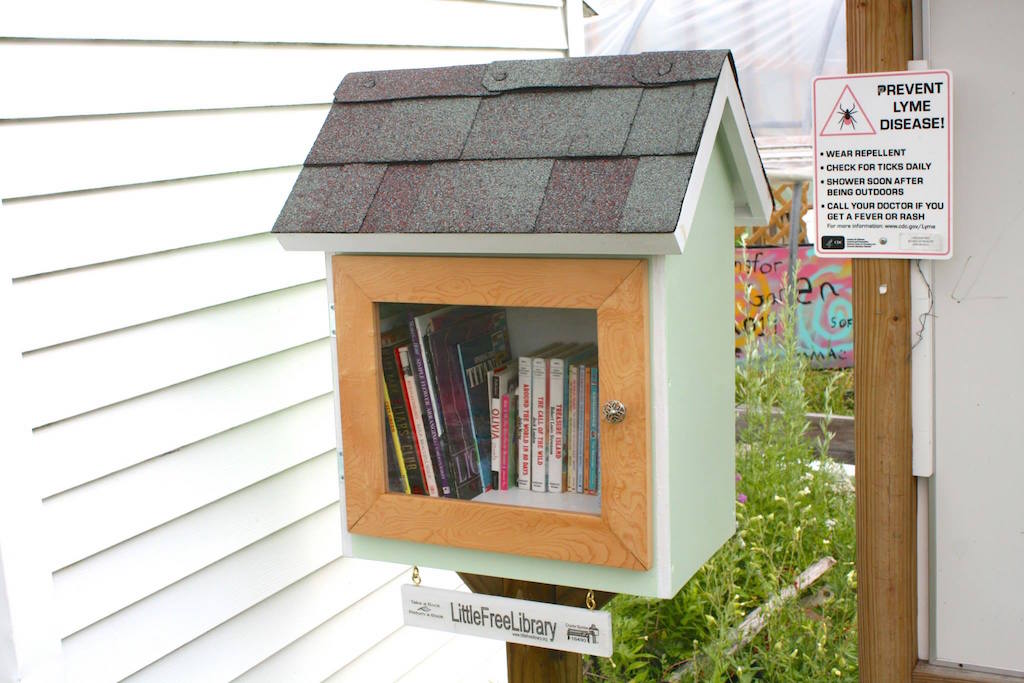

Little Free Library for the community garden

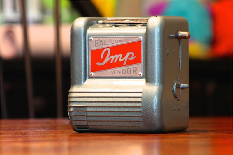

Ok, I know it's off topic, but one more. This is a little Trade Stimulator (slot machine) that I restored for my father's birthday a few years ago.
Before:
And After:

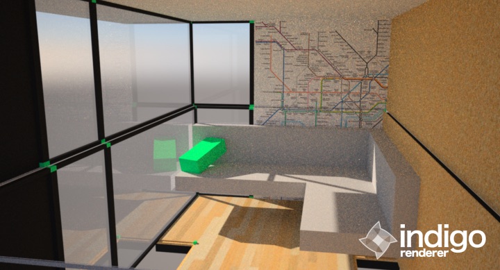

Coolest thing ever, and probably the most modern design on the forum I've ever seen!
I guess you would need some kind of soft rubber gasket to seal the pop up bit. Im assuming your huge windows are some kind of plastic... I would just worry about scratches on those when elevating the top....
