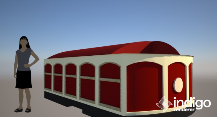

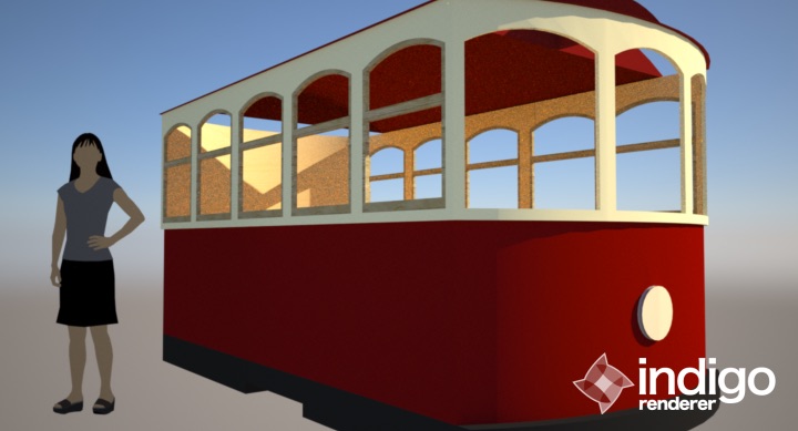

...Or Tram for those not from America. I posted my boxy minimalistic home design a few weeks back, but was told it would probably lead to terrible gas mileage, so I started thinking about a curvier design that my kids would like.
Here's my first few rough sketches, please forgive the lack of door, or the missing part of roof, those compound dome-like shapes are really hard to make even with "follow-me" :?

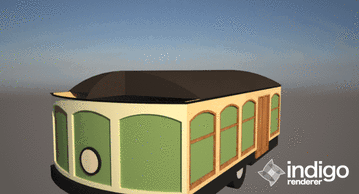

Added a few more touches, changed the roof color, added a door with stained glass, positioned the wheels, etc.

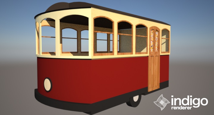

Had to square the door again for folding issues/gaps. I also changed the color to a patina green, and created an animation of the folding process. I think with an awning, this will be a really fun popup.

I have been working on solving this in my own build design. I keep coming back to that for a whole lot of reasons (relate to alignment/weight/windows cracking exposure/waterproofing and WEIGHT) it needs at-least one permanent durable hinged and well sealed side facing direction of travel. Any ideas on potential mechanism used to hoist that up after driving all day without throwing out your back or taking up lots of space and weight?

The design looks fabulous. The details may prove troublesome though. Whatever method to lift will need to keep the top level or very near level (actually in the same plane as the bottom). If it racks going up it will bind. The door opening is on two different planes so the jamb design will need some attention. If you can work these out you'll have one helluva TTT!
