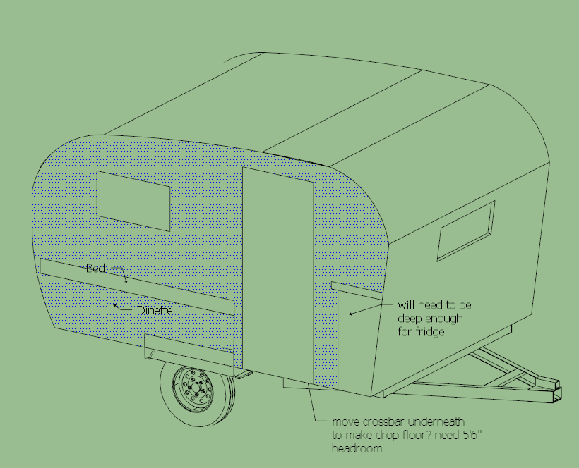

Just found this great forum a few weeks ago! thanks to ryan, I had the northern tool 5x8 sketchup file to play around with. I really like the shape of the shasta compacts and tried to come close. This was some quick doodling I did. Any glaringly obvious problems with diving deeper into this design? I like the idea of the widgets/puffins etc and think i'd like the same layout. counter space, small bathroom, closet with a/c. foldout dinette etc

This is a SketchUp drawing. The free downloadable version works.
BTW for those without the software, the design has the outer skin with some detail eg door, windows; the trailer in high detail eg wheels, C-channel cross members, tongue detail. The inside has little detail, so hard to determine things like fridge placement, etc.
I think you need a little more on the inside detail to see how things will actually fit. Like the fridge, what are anticipated dimensions? In my planing, I have a range of possible and have created a space for the expected unit. The same thing for the foot well given the current placement of the trailer rails/cross units/tongue supports.
Most people do not design all the details like how exactly will the sides attach to the bottom; details on the hatch and edge water barriers (if you had a hatch ), door installation eg hinges, trim, window; how the inner, outer roof will be joined to the walls and spars; what to do when working with materials that have to be spliced together to get the correct size. One really needs to work on this at some point.
Other things to include : cabinets (currently none?), what electrical system you will have and where will it be contained, water system (?), propane, solar. Many people leave wiring pathways to a more ad hoc solution -- although planning is always good.

Here's his design.
Here's a screen shot of his design to comment on.

I like the idea of a shasta compact shape on this trailer if the weight can be kept down. There is around 220 sq ft surface area in the walls. Maybe 4mm plywood with .75"x.5" studs every 18", poor man's fiberglass over that?
I liked the idea so much I sketched up what I would do inside there; queen sideways and two bunks forward, top one swings out of the way for sitting. This version is 7 ft wide, 12.5 ft length overall, 6.5' tall (almost the same as the original compact but a foot shorter.) I put in a drop floor between the tongue pieces, there was 4'3" width there. That gives 5.5' headroom on the drop floor. The galley would have to be kept very light given the axle placement, but the placement looks about right compared to the original Shasta compact. I lowered the whole profile onto the trailer a ways to cover the trailer frame.
