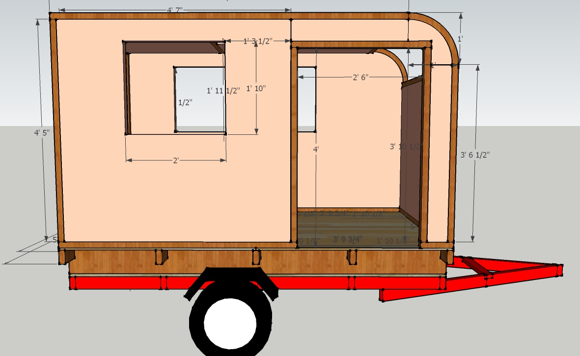

Door Side has a 48" tall, 30" wide door and a 24" wide, 22" tall window:
Camper with SIPs frame door side.jpg (228.88 KiB) Viewed 7661 times

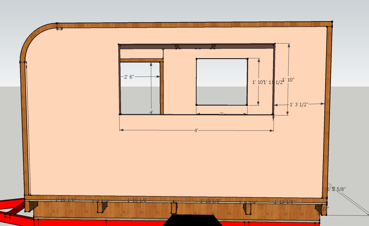

Window Side has a 48" wide, 22" tall window:
Camper with SIPs frame window side.jpg (201 KiB) Viewed 7661 times

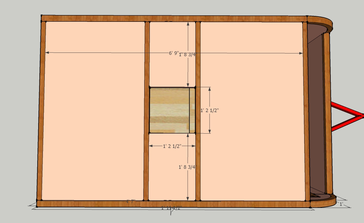

Top has a cutout for a standard 14.5" square vent:
The attachment Camper with SIPs frame top.jpg is no longer available
Camper with SIPs frame top.jpg (158.84 KiB) Viewed 7661 times

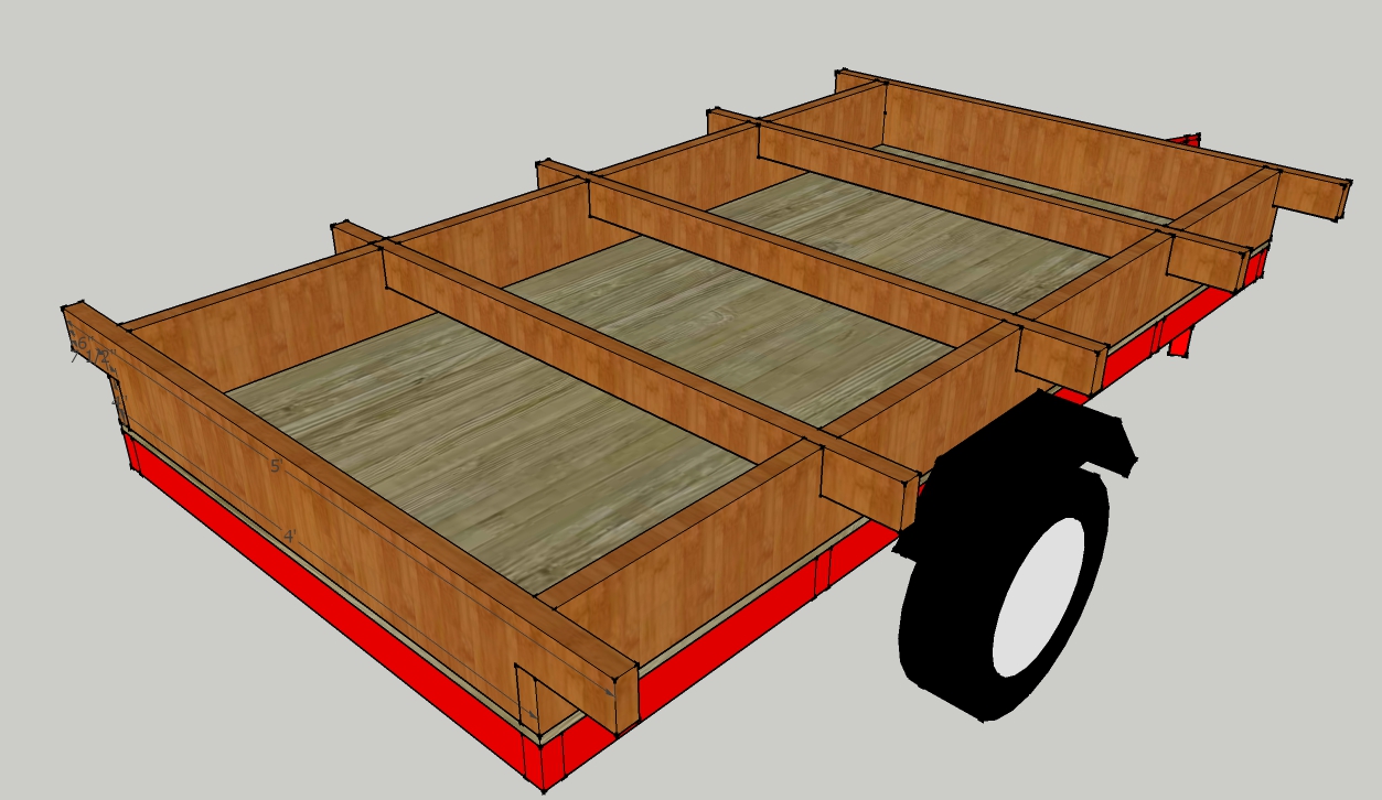

I used a floor frame to raise the floor above the height of the tires in order to expand the width to 60". This allows me to have a full size mattress. It is made of 2x8's and 2x4's. A 1/2" plywood floor sits on it. Under it is a 3/4" plywood sheet. There is a good amount of storage space. I have not decided how (or if) I will insulate it.
Here is a picture of the floor frame:

This is alot better than the first design. On the floor I would think that 2x4's on the frame should get you high enough to clear the fenders. It seems to me that 2x8's is a bet of over kill, your not going to dance on the floor just lay on it.

Depending on what you will have for trailer xmbr's and what you plan to stow in the basement (doesn't look like there will be room for much) you could probably get away with 3/8 ply (or thinner) on the trailer deck.
Another option would be to eliminate all of the 2x4's spanning under the cabin floor and instead bisect the space with a plywood rib running down the space longitudinally (like Desert Moose did). That way the span is cut in half and you get the full depth for storage. Consider partitioning off the front of the basement with access from outside; otherwise it would be difficult to reach stuff that slides forward underway (unless you plan on having floor hatches, which can be a pain to get to under the bedding).

As for the floor frame, I over-engineered it because I am a big guy (6'6", 400lbs), so I think I will stick with the 1/2" plywood and the 2x4 ribs. Replacing the middle rib with a plywood divider is a good idea though. I will add little scrapwood stops to prevent items from rolling about in the basement.

In the floor frame, I replaced the cross pieces with 1/2" plywood on both ends and the middle. The second and fourth cross pieces are now 2x2s.

I had a thought about making more interior space for your trailer and also cutting down on weight and maybe even height. you have your horizontal 2x4s sitting on top of notched fore and aft 2x8s. if you remove the 2x8s and adjust the position of your 2x4s slightly, you can still raise the floor above the wheel wells without having a tone of "dead space" forward at the door. you could keep the raised floor above the axle but then drop the floor down 4 inches or more forward of the axle to facilitate a lower door, and give you and extra 4 inches of standing room in the front. this also has the benefit of removing two 2x8s that are hefty and are not adding anything in the way of strength (since you already have 2x4s going side to side.
