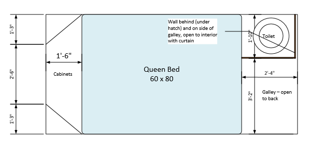

Floor plan (cabinets and galley not yet designed)

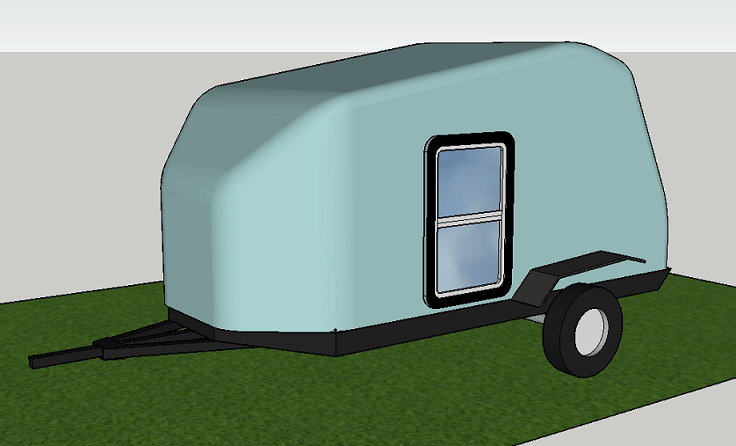

I'd like to hear some opinions on the designs ... do you prefer the one with the sharp edges, or the one with the rounded edges?
Angular body
Rounded body

Rounded!
I'm not convinced that the porta potty in that location is going to be practical. Just trying to visualize the gymnastics required to use it. I think a side tent to put it in might work better. Reclaim the space for your galley.

Rounded...and I agree about the Porta Potti. This is where a pee bottle comes in handy for us guys.

hmmm... I'm a bit partial to the square one... but I can't quite put my finger on why... :thinking:
Radius-ing (is that a word?) the edges creates a pretty neat effect. Creating that with foam might be difficult. The compound curves (all the corners) would be the hardest part. Good luck with it though! Would be cool to see either created out of foam!

I was beginning to think that no one was going to chime in on the two designs. I think I'm partial to the rounded one myself, although either would look great.
I think I can build a hot wire jig to do the 'radiusing' of the edges after it is all glued together. I would do all the 'right angle' edges first, then modify the jig to do the other edges that are not joined at right angles.
You all may be right about the porta-potty. I may just have to use a pee bottle with a lady j attachment for my better half and use the space for a full galley and AC unit.

I do like the rounder version also. Seems like you would need to laminate some foam on the inside - almost like a "cornice" so those joints don't get too thin. I don't think those planes truley meet at 90 degrees, so a little bit of a challenge to build the "cornice".
I think you really have to want it to justify what seems sure to be a lot more work.

My build is similar to your "softened" rounded version. It's a 5 wide 10 ft. Sorta weekender, with a narrowed, rounded nose (kinda like yours). I wound up doing the rounding by hand after after abusing a lot of brain cells trying to devise a hot-wire jig to do the job without jig deformation, etc. Decided to spend the time by doing instead of pondering. worked out OK using a coarse file, followed by increasingly finer sandpaper, down to 180 grit. 80 grit was very effective and good to work with. Lotta dust masks....
I believe quite a few folks have done rounding on foam corners, if I remember correctly. The compound angles didn't really present much of a problem (at least as far as rounding went). I did not add additional support such as a cornice, although I thought about doing so. The double thickness of canvas due to overlap inside & out left the roof-to-wall joints rock solid.
The cuts for the angles (other than the roof) leave you with a thicker cross-section than the original 2" foam, so you can shave & round them without losing much, if any of the original thickness. plus the angle adds strength at that joint............I can't say if the canvassing was more difficult due to the rounding, since it's my first build, but the compound angles can be challenging when using PMF. At the front upper in/down angle, I wound up with three layers of exterior canvas in a small area on both sides......On the bright side, it's really, really strong there!..............jd

Both are pretty cool but I like the rounded corners the best. The rounded edges should create less turbulence for an easier tow. Just my two cents.

Remember that hot wire knives don't go through many of the glues/adhesives used in foamie construction. Not sure about GS or GG, but they will not go through TB2, PL or epoxy well at all... at least not as easily as the foam, so stalls and wire worming are likely to be an issue. Plan any joints and built up sections of foam accordingly.

They both look good. But if I were to build it, I would go the square route because I'm OCD. If those rounded corners weren't perfect and identical and symmetrical, it would drive me nuts. Much easier to work with straight lines, and much easier to repair/rebuild/redo if needed. And it'll still look nice with a skin on top to make slightly soft edges. That's my opinion though.

Are you fiberglassing the foamie? If so, I would think rounded corners would definitely be better. You could fiberglass the foam and then top coat it with the product of your choice.
Also, if you splurge on higher density foam, you can sometimes use a sander to shape it.
