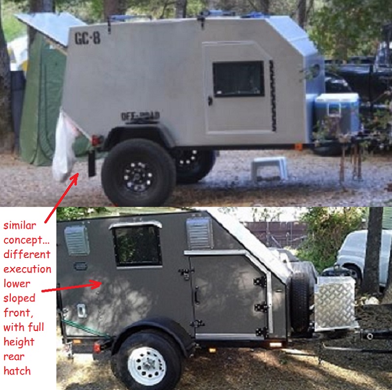

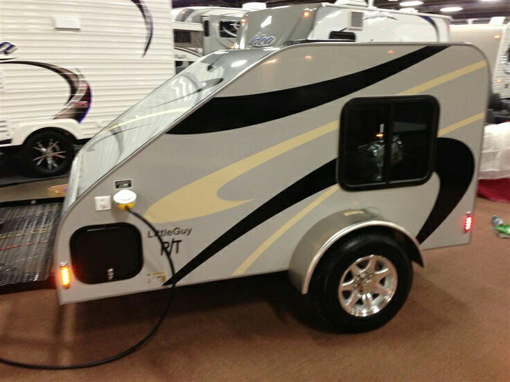

  • The Little Guy RT is a good-looking variant of the "simple" design,m with rounded corners/edges for aerodynamic streamlining, in lieu of the normal teardrop shape. irgod32 constructed his "simple" variant with rounded front corners for some aero benefits, but the rear remains predominantly square, as does my TTT. I wanted to build mine using simple, straight cuts, as much as possible, sacrificing the streamlined teardrop shape entirely. THe Reverse Tear has kept rounded corners on top, but squared on the bottom, and with a large square/flat rear, so it's somewhat more aero than irgod32's trailer, and significantly more than mine.
    simple-style, offroad & semi-offroad TTT's.jpg (189.62 KiB) Viewed 5892 times
    simple-style, reverse vs. conventional forward entry TTT's.jpg (200.08 KiB) Viewed 5892 times
  • But, the Reverse Tear departs from the conventional teardrop, or even the "simple" squareback TTT design, by having no rear galley/storage area (mine is storage only, with no room for cooking!), and puts a single entry door at the rear, instead of a hatch accessing the galley, on the side(s), like more conventional designs. It's a good way to get into the cabin, if one is not limber enough to enter/exit a side door (at 67, with bad knees and back, my TTT is getting sorta difficult for me to get in or out now), but then the trailer is unable to to serve as a cooking area, or have a large storage compartment onboard (there is small side compartment for storage, though...perhaps a slide-out "kitchen/countertop could be installed there?).
  • Since a lot of teardrop/TTT campers use canopies and/or attached side tents for sheltered cooking areas, or for clothes-changing/porta-potty rooms, the rear entry door could have a similar set-up, underneath one canopy? (I use one or two canopies, and one or two side tents, having two doors and a rear hatch, with extra side-tables and cooking stand, to cover... lot of things to put up or takedown at camp). As I see it, the Reverse Tear (or clone) should be a good design alternative to more conventional types of small camping trailers, provided that you are prepared to camp lightly, or have extra storage and cooking options available to you.
