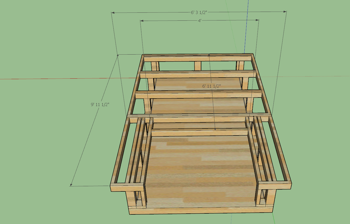

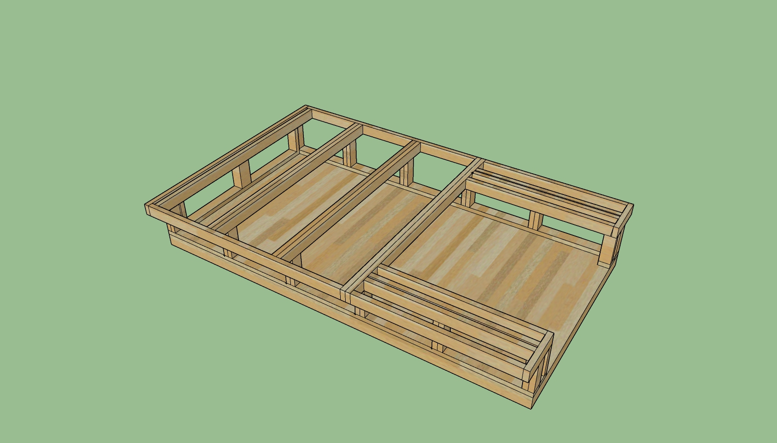

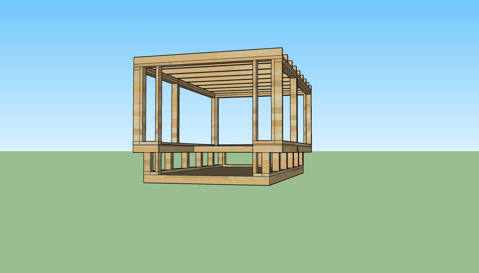

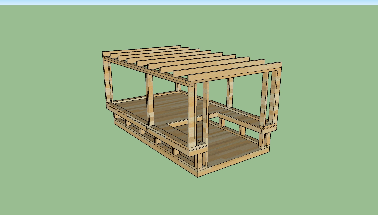

Hello,
I recently acquired a 5.5' x 10' trailer. I have been in love with the idea of building a camper since I first found out about teardrops. The problem is because I use a CPAP to sleep, I wanted to build something squarish to mount my solar panel on to in order to provide power for the CPAP. So I apologize in advance this isn't a teardrop. The design is a simple framed box around a queen-sized bed that I could put .25" insulation on the outside of, then fiberglass.
I know you folks have way more building experience then I do, so I wanted to share my plans to see if I was over-engineering it.
Please see attached. Thank You in advance!

Postby Ottsville » Tue Jul 24, 2018 12:54 pm
I like the direction you are going. Are you planning on sleeping side to side or putting boards in to sleep front to back? '
The drawing looks like you will be framing it in 2x material, is that your plan?
Ottsville
Posts: 327
Location: Virginia
Re: Feedback on Slide-in Camper Plans
Postby cryptojones » Tue Jul 24, 2018 3:23 pm
Ottsville wrote:Are you planning on sleeping side to side or putting boards in to sleep front to back?
I guess you can't tell without measuring but the flat space in the back perfectly fits a queen matress at 5'9"x6'x8".
Ottsville wrote:The drawing looks like you will be framing it in 2x material, is that your plan?
Yeah. I went with 2x4 because I that is what I am familiar with. I could split them and do 2x2s.
Postby tony.latham » Tue Jul 24, 2018 4:58 pm
Using 2x4's is gross overkill. It'll weight a ton.
A better way would be a classic sandwiched wall using skeletonized 3/4" plywood.
:thinking:
Postby cryptojones » Tue Jul 24, 2018 9:43 pm
tony.latham wrote:It'll weight a ton. Tony
Each 2x4x8 weighs 13 lbs. It would require 154 to reach 2,000 lbs. This design does not use anywhere near 154.
Postby tony.latham » Tue Jul 24, 2018 10:02 pm
You're right. With the trailer chassis, it would come in somewhere below that. I'll guess about 1600 pounds. My sandwiched walled teardrop weighs 1300 empty.

Postby KCStudly » Wed Jul 25, 2018 6:51 am
The weight adds up quickly. The only place I have any stud lumber in my build is the blocking for the side door latches, and the blocking for where the floor bolts to the trailer frame, maybe 2 or 3 ft total.
I suggest you start at the very beginning with a mind set of making everything just 10/ct heavier than "this is too weak", instead of 200/ct heavier than BMFH (Big Mother Freakin' Hammer).
Sure it's more effort to find, buy and/or rip down suitably sized sticks, but of all of the stud lumber builds we have seen, not a one has said, "I wish I had built heavier". On the contrary, we have seen broken tongues, broken springs, and maybe even a bent axle (IIRC).
Have a look at Sharon's finished build weight comparison chart (and a companion thread http://tnttt.com/viewtopic.php?t=60392). Take a look at the campers of similar size to what you have planned and look at their build journals to see the type of construction they used. The campers outlying the graph on the heavy end of the plot (for a given floor size) will be those that overbuilt using stud lumber (and possibly lots of extra features, such as onboard water, a/c, generators, solar panels, extra batteries, etc.); whereas the ones in the "sweet spot" of the plot used more commonly used materials and methods, with some restraint of features, to keep things at a more manageable weight.
Remember, even if your TV has all the pulling power you could ever need, your hauling experience will be better when the actual finished weight is less, and especially when that finished weight matches the axle, spring and tires you have selected. There are plenty of examples of people that ending up heavy and wishing they had not started with stud lumber.
As they say, "think airplane, not tank".
