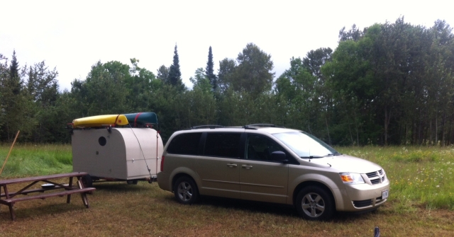

lfhoward wrote:That’s a good looking design!
Here is a resource I found that will help you get the weight balance and axle placement right.
https://www.engineersedge.com/calculators/trailer-weight-balance.htm
The key is to have 60% of your weight forward of the axle when loaded (galleys can be heavy). Also, 12-15% of the weight should be tongue weight to eliminate sway when towing.

Pmullen503 wrote:Rethink the barn door at the galley. It places a lot of stress on the back edge and it like a sail on a windy day. A hatch hinged at the top will be less susceptible to wind and provide shade and some shelter from the rain.
30dayreviews wrote:Pmullen503 wrote:Rethink the barn door at the galley. It places a lot of stress on the back edge and it like a sail on a windy day. A hatch hinged at the top will be less susceptible to wind and provide shade and some shelter from the rain.
Yea the reason why I'm not going with a hatch style is due to the fact I will be having my canoes up top for easy access and where the height comes to I would hit my head on it when closer to the rear. I am thinking about the possibility of barn doors however at the moment I'm planing on just the single. I am thinking of putting a latch system on the end that will go down to the ground to hold it in place as well as remove the weight off of it. I do have a question about it posted as well.

iggy3860 wrote:30dayreviews wrote:Pmullen503 wrote:Rethink the barn door at the galley. It places a lot of stress on the back edge and it like a sail on a windy day. A hatch hinged at the top will be less susceptible to wind and provide shade and some shelter from the rain.
The canoes on top does pose an issue. Have you considered a double barn door style similar to semi-trailers [Aussie description]? That could address the canoe storage issue & help reduce possible back edge loads.
rjgimp wrote:30dayreviews wrote:Pmullen503 wrote:Rethink the barn door at the galley. It places a lot of stress on the back edge and it like a sail on a windy day. A hatch hinged at the top will be less susceptible to wind and provide shade and some shelter from the rain.
If you do go with swing doors I suggest one half at each side to reduce problems with too much weight hanging off a set of hinges. You asked in another thread about sealing. Look at how cargo trailers with such doors are constructed, or even take a gander at a semi trailer. Specifically look at a refrigerated trailer. If hauling groceries they are required to have a seal that is food safe. That would certainly keep your galley clean and dry.
