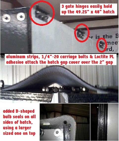

Postby working on it » Mon Aug 09, 2021 11:22 am
Tomterrific wrote:With mine, the hinge leaked due to capillary action....
* I don't use a continuous hinge, using gate hinges instead, and there's a 2" gap left between the roof and hatch door when opened. I covered the gap with old conveyor belt material, very durable, but it surprised me at first camp when it rained; there was a constant drip along the covered gap, because the conveyor belt material has thousands of tiny pinpricks in it, probably to let air pass-thru to make it slide on the conveyor surface easier. I never thought about it before.
* I grabbed a can of Herculiner bedliner spray when I returned home, and lightly coated the upper surface of the material. It leaks no more.
