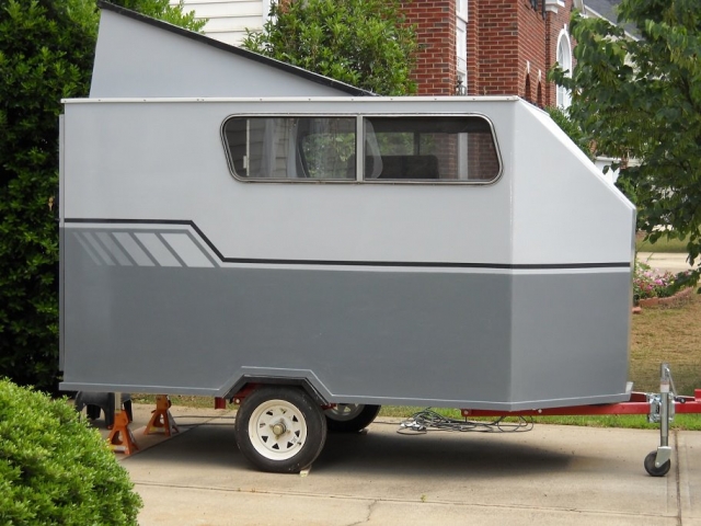

HOA restrictions require a trailer to be kept in the garage. When I built a standy many years ago, I made it garage-able by means of a pop top. I am starting the planning of my next standy build to be able to store in the garage but with no pop top. My plan is to have a removeable pod that slides off a utility trailer. The pod will have small wheels in the back so that when it is off the trailer it can be wheeled into the garage.

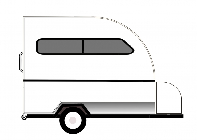

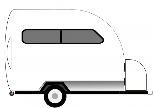

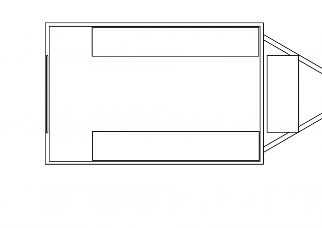

In this first offered profile, I have built into the the back end of the trailer some handrails. They are there to be able to move the pod from the utility trailer bed. In addition, this profile is actually 9 feet long. Wanting to keep the trailer light without a lot of windage as well as make it using 8 foot material. Obviously this needs to be light enough for a single person to move it from the trailer. To that end I have reduced the profile to 8 foot.

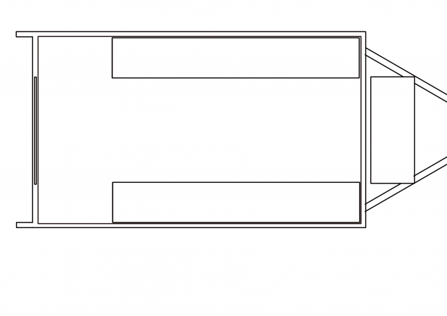

Postby StandUpGuy » Wed Dec 29, 2021 9:08 pm
9 foot plan
8 foot plan

Postby QueticoBill » Thu Dec 30, 2021 6:44 am
FWIW, my plan for a removable cabin is 4 casters more central and a means to lift the cabin and pull the trailer out from under.
QB

Postby RJ Howell » Thu Dec 30, 2021 8:18 am
Are you opposed to any type of lift roof? I have always liked the Alto Safari roof lift https://safaricondo.com/en/caravanes-alto/! Just don't like their build quality.. Others here have done similar to it.
The wheels on the rear are a cool idea. I see jacking the tongue and sliding it off like a dump bed. Furniture dolly's as the front comes off.
You going foamie to make it lightweight?

Postby StandUpGuy » Thu Dec 30, 2021 9:05 am

Postby StandUpGuy » Thu Dec 30, 2021 9:07 am
QueticoBill wrote:FWIW, my plan for a removable cabin is 4 casters more central and a means to lift the cabin and pull the trailer out from under.
A good plan. Especially if the pod is big and heavy.

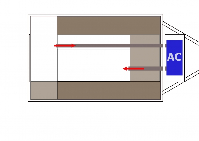

Postby StandUpGuy » Mon Jan 03, 2022 2:56 pm
I am starting to develop a floor plan. I should state my objectives. 1) I want a couch and table to convert to bed. 2) I want to use a, somewhat remote, window AC unit in the front storage to eliminate as much noise in the trailer as possible. 3) I want to be able to use the trailer as a transport for a large scooter I have. So anything in the way of the scooter needs to be easily removed. 4) keep it simple and light so I can slide it off the utility trailer.
First I am mostly thinking about how to handle the AC unit. Maybe mounted with big rubber dampening mounts of some sort. perhaps flexible ducting into the trailer. Or maybe something less restrictive. Maybe fabricate some large rubber rectangular duct.

Postby JasenC » Sun Apr 03, 2022 10:30 am
I like the 9' design.
You could graft on the extra bit of ply with a 6" 1/2 lap
Your old pop up is similar to what I'm planning, but no pop up.
