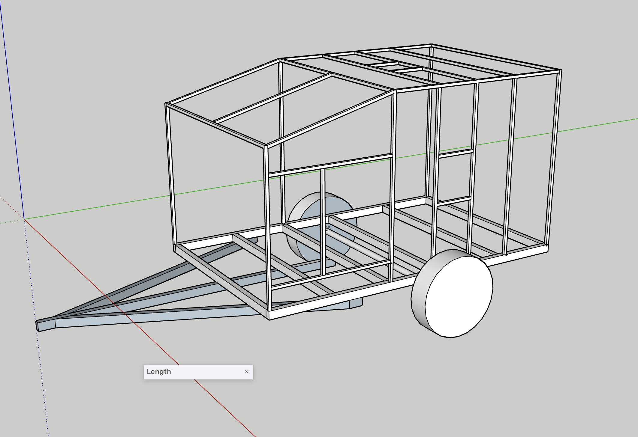

Hello everyone, first time posting on here, I’ve attached a photo of what I have currently drawn up. The main cabin is roughly 6x10 and total trailer length is roughly 15ft. Trailer frame will be 2x2 .122 and the cabin frame is 1x1 .108. Is there any glaring issues you can you see that I need to address?

It's hard to tell with that angle, but the axle appears to be too far forward. It should be at the 40/60% point.

Just one vertical on the curb side? None other than the corners on the front and back?
