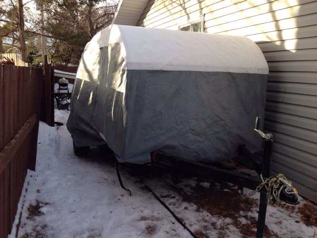

We are trying this cover for our trailer's first winter outdoors. We bought a Classic Accessories "R-Pod" cover. It's apparently waterproof but breathable. All the RV dealers around me say they work and wear well. To get a nice fit since the Rpod is a much larger trailer than my 5x10, my wife and I took the cover apart and cut the cover down for a near perfect fit on our trailer. We are happy with the DIY mod to the cover and it worked out cheaper than having a custom cover made.

I talked to a local gal here that does a great job on sewing up boat covers. $400! or was it $500? Anyway, it was too much. I bought one of those RPOD covers from Amazon for a $100. I think it was a return.
I piled it onto my 5x10, marked it, cut some off the bottom, took some in at the corners and it's like a gal with a well fit prom dress now. It came out great.

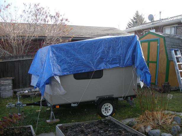

I built a hybrid foamie this year, and just tucked it away for its first winter. I used tarps, because I had them already and I'm not quite sure how much protection my little trailer will need. We get lots of snow in Alberta, but mostly the weather is dry and windy, with mold not being much of a problem. The roof of my trailer is angled, as well, so that rain will tend to run off it. I will check on it during the winter and see how it holds up.

For Sheryl and others using tarps on their TDs over the winter - don't you hate when the tarp gets beat up from the wind and the grommets blow out after a few good wind storms ?
We are full-bore into our winterizing and storing regime for customers' boats and it occurred to me that everyone might not know these little 'tricks' that will let the same tarp survive all winter, despite some wicked windstorms we get here on the wet coast:
1) Instead of tying the bottom down tight, use the lines to hang to hang bleach bottles a foot or so off the ground. Then add enough water to the bottle to give it a bit of weight (adjust to suit). This will give the tarp a bit of give when the wind blows and it won't get blown out and ragged.
2) instead of using rope or string to tie it down, tie a loop of shock cord (or a bungee) through the grommet, and tie your line to that instead. That too will allow some give when the tarp tries to inflate or lift from the wind, and it will suck back down again. Adjust the size of the loop and the thickness of the cord to suit (1/4" thick cord should be lots for these)
Let's hope everyone's TD makes it through the winter dry and happy till camping season rolls around again 8)

Thanks for the tips, Wobbly Wheels! :thumbsup:

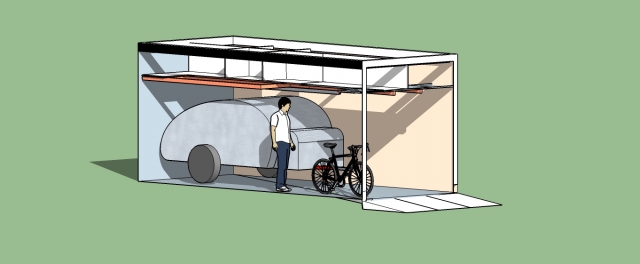

I know I'm coming to this very late but... I have recently invested in a 20' shipping container so I can store my tear drop in. It was already sprayed with insulation so it's dry and snug. I,m going to fix it up with storage across the top like this:
The weather is pretty bad here in Ireland so it is not really overkill :)

This is an update: my little trailer is looking fine after its first winter under a tarp. The dry climate here in Alberta is a help- mold is not much of a problem. Best wishes to everyone for camping season! :thumbsup:
