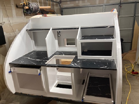

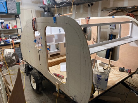

Postby Dan P » Wed Jan 26, 2022 8:33 pm
From what I've read in the forum, people seem to like pictures.
Here's a few on my build. So far so good for a complete rookie woodworker.

Postby MickinOz » Thu Jan 27, 2022 9:08 am
I would suggest that you wouldn't put sheet FRP on that.
I'm assuming you are in the US where everything is more readily available and usually cheaper than it is here in Australia.
You should skin it with thin plywood, then consider one of the many extra durable top layers available to you.
e,g, PMF, Aluminium sheet, epoxy resim with woven cloth, etc.
