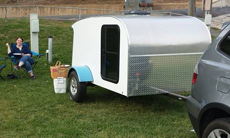

I have a neighbor who's used it on a couple of TD's now and it's worked great.
ken's TD.jpg (24.5 KiB) Viewed 6448 times
He's always used a contact cement but this thread got me thinking about letting it float hence the questions.
