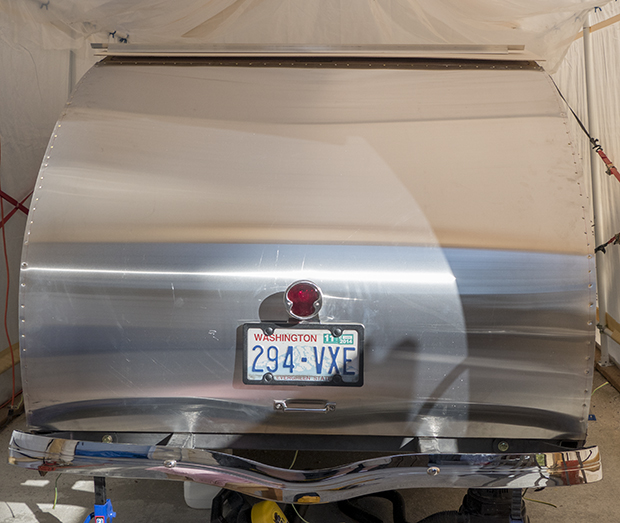

Postby RunnerDuck » Thu Oct 06, 2016 1:47 pm
What I did on my galley hatch and plan on doing on the roof is Loctite PL all the way around and then staple to the sides.
Skinned Hatch.jpg (233.46 KiB) Viewed 3842 times
I know it's not a full "float" but it looks like it will work.
Before I do the roof do you see any real problems with this approach?
