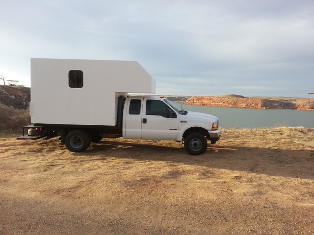

Postby MudFlap » Sat Jan 30, 2021 11:03 am
Greetings.
I wanted to update this thread with a picture of my finished build, and thank the members of this list that offered lots of help.
There's nothing very exciting about this camper (or build). Construction was a mix of several techniques, with an emphasis on making a well insulated camper since we do lots of cold weather camping.
The one area that was very new to me was working with fiberglass (which was used to coat entire exterior). The members of this forum came through Big Time to give me the skills and confidence to tackle that part of the project. Many thanks for that.
Here's the final product. I mounted it up on an old work truck last week and took it out on its maiden voyage this week. After having spent many years sleeping in the back of an uninsulated cargo van, this camper felt like a 5-star hotel!
Thanks again!
MudFlap
Posts: 19
Joined: Wed Jan 03, 2018 4:21 pm

Postby tony.latham » Sat Jan 30, 2021 11:34 am
Baloney. It's a one-of-a-kind. Hand-built. :thumbsup:

Postby Tom&Shelly » Sat Jan 30, 2021 12:37 pm
MudFlap wrote:Greetings.
Thanks again!
Looks great! :thumbsup: :thumbsup: :thumbsup:

Postby pchast » Sat Jan 30, 2021 10:33 pm
Glad its worked out for you. That looks good from here.... :thumbsup:
How about some pictures of the back and inside?

Postby OP827 » Mon Feb 01, 2021 7:35 pm
Hi MudFlap,
This is probably the shortest build thread I have ever seen here :lol:, congrats :thumbsup: :applause: ! Hope to see some more pictures outside and inside..
Thanks for sharing.
