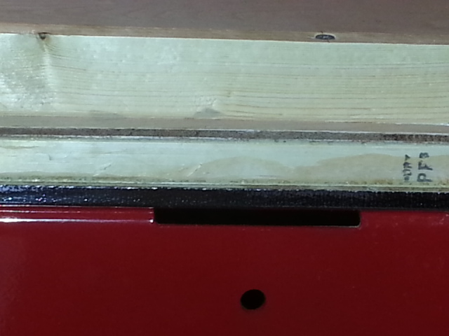

The top piece of 1x2 is what my external skin will attach to. You can see the silver "Titie Seal" and the exposed floor board framing.
I applied this Tite Seal to the underside of my floor; seems like a great product. My retied Marine brother used the "USMC Quality Test" :lol: on a sample board...he took a hammer and struck at it with solid glancing blow to simulate a large rock bouncing up into it, there was a slight tear, but between the two of us, we don't think any large rocks would really strike the floor that hard. Overall, Marine tested and approved :twisted:
Now for the questionable piece...we let the tite seal material fold over the floor board only enough to cover the under carriage board so when looking at it, the 1x2 framing and the inside floor boards outside edge is not sealed. The wall will sit on the floor and not cover the side.
I do not know why I did it this was, but now I need some suggestions on what to do about the exposed floor edges.

I'm not sure what I'm looking at there. Perhaps you could describe it from the bottom up.

It is my floor...from the bottom up.
1 - Lowest layer is "Tite Seal", this was applied to protect the undercarriage from rocks and water.
2 - The silver edge is the "Tite Seal" folded over the outside edge of the undercarriage; this is 1/2" Baltic Birch 4' x 8' Plywood.
3 - Then the framing for the floor is 1" x 2" Furring Strips, this is the piece of with the "pf" stamped on it;there is 3/4" insulation nestled in the framing laying on the undercarriage.
4 - Then there is a 1/4" Baltic Birch 4' x 8' Plywood. This the floor inside the TD, there is a ledge there where my wall (outside skin) will rest on.
5 - The top is another 1" x"2 furring strip screwed to the floor (see the screw going into the 1" x 2" from the top), this is what my walls will be attached to.
My walls will rest on the floor and be attached "screwed into" the 1" x 2" Everything below this 1 " x 2" furring strip is the floor board and will be exposed. As it stands, I have no plans on covering the edges with any type of cosmetic trim (aluminum, wood or ....).
What I was hoping for, are suggestions on "SEALING" the edge of my floor board.
IslandStorm62
Posts: 90
Joined: Mon May 20, 2013 6:57 pm
Re: Undercoating Alternative (No more sticky black stuff!)
Postby KCStudly » Sun Jun 16, 2013 1:12 am
Ah, I see it now. Thanks for the explanation. :thumbsup:
Many options for sealing that bottom corner.
1. "The Mix", various ratios of oil based poly and mineral spirits.
2. Straight or water thinned TB2; or a coat of each (water thinned first for penetration).
3. CPES (expensive), either multiple coats or covered with an epoxy coat.
4. Straight epoxy.
5. Epoxy and glass composite.
6. Canvas and glue or paint (foamie style).
From what I gather the CPES is rather dear and many folks feel that there is no need to bother if you are using regular epoxy over the top.
On TPCE I used TB2 thinned 1 part water to 2 parts TB2 on the underside of my floor, followed by a coat of straight TB2 and I have to tell you that it seems to be fully adequate. Before I am done I will probably add a coat of exterior latex paint and never think twice about it.
No black goop? Heresay? Maybe, but the TB2 set up hard as epoxy and has not scratched or flaked while dragging my walls over it and using it as a work surface.
