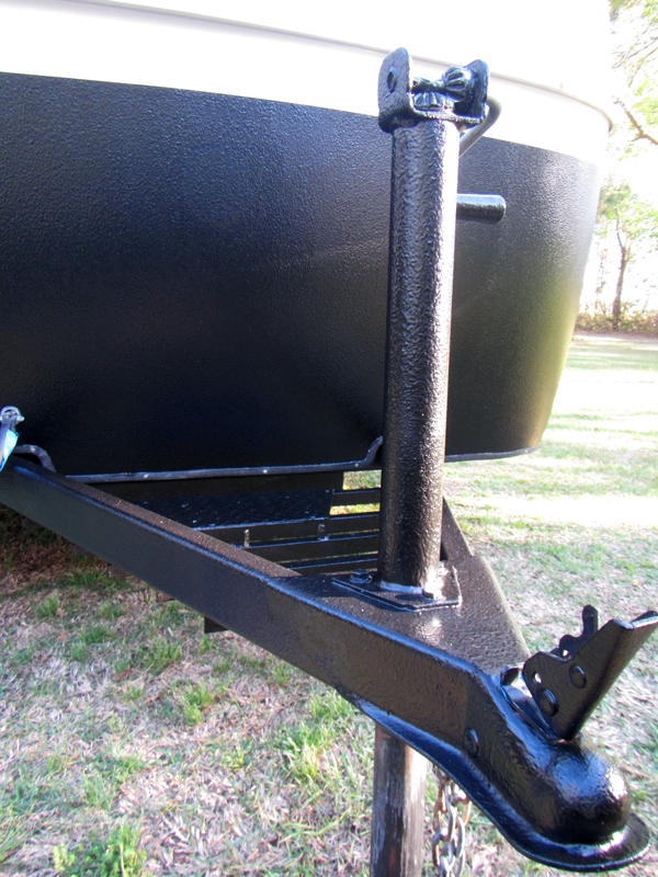

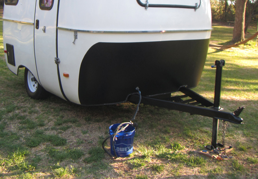

Just saw this post. I put Monstaliner on my trailer's fiberglass front end and the chassis in spring 2017. I chose Monstaliner for the UV protection and good reviews. It can be rolled or sprayed on. I rolled it. 39 different colors to choose from.
I followed instructions with sanding and a wipe down with MEK. Rolled two coats. One gallon just covered two coats of the front end and chassis.
Almost two years later, it's held up well. There are a few tiny chipped spots from road dings, which expose the white fiberglass or metal underneath, but not enough to warrant a touch up yet with a quart of paint. Maybe in another year or two. Overall, I'm happy with the product and would recommend it.
