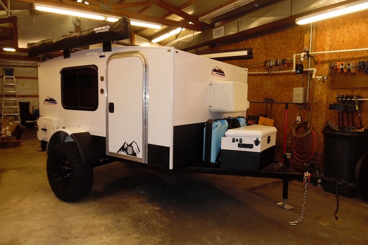

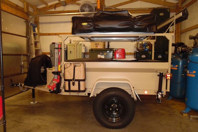

when I was converting our 2019 Runaway Range Runner into a offroad trailer, rock chipping was a concern. I knew my last offroad trailer build 3rd photo I used a spray on bedliner & was impressed how well it held up (I used the tintable 2 stage bedliner). So this current trailer modification build I used the same brand but in black & again I was totally impressed how well it held up running trails, dirt roads to dispersed camping spots.I applied to the front rock guard, faces of my fenders, lower portion of the tongue box, the side alunmium diamond place pieces I cut to size, the front tongue rails, & the Scepter Water Can Holders.
