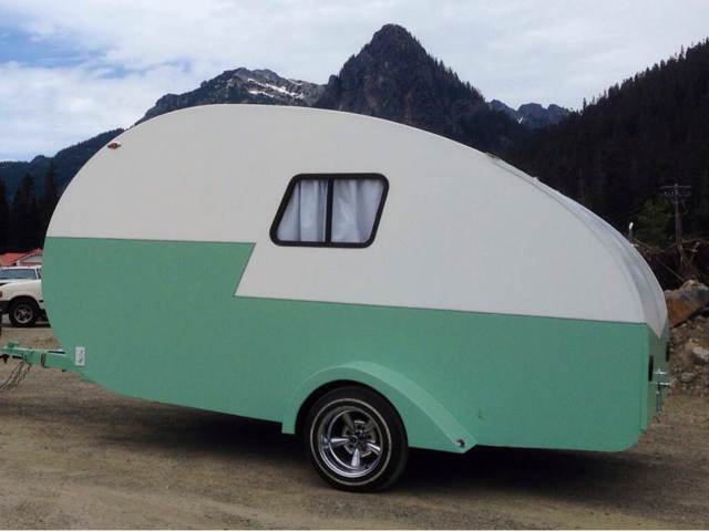

I took a page out of the foamie manual and used TB2 and cotton muslin (muslin was in lieu of heavy canvas since I didn't need the structural component like a foamie would). I the. Painted with a two component Acrylic Epoxy paint. It wasn't the quickest solution, and has only been on the road for 5k miles but so far so good.

Fyddler... that looks Super !!! :thumbsup: 8)
