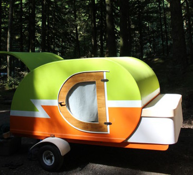

Basically, yes. I did some very intricate detail work around my doors and hatch. The nice thing about canvas is that you can pull it, stretch it, poke it, manipulate it - I even sometimes used a low-medium iron to help set the canvas and glue in particularly difficult spots.
If I know a particular detail would be challenging, I sometimes mocked the detail up first to see if it was possible. If you are interested in using this technique, I highly recommend trying it out on scrap plywood and any fabric and paint. You quickly get the hand of it.
Sometimes you won't be able to a detail in one piece. A nice clean seam, with a bit of overlap is to be expected - just work as neat as you can.
