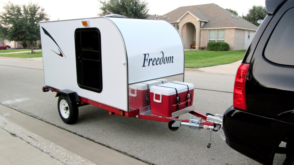

Postby TxDave » Tue Oct 21, 2014 10:29 pm
Hi Michael,
I used Filon on my recently completed "non-traditional" teardrop. This was my first attempt at building a trailer. I found the Filon to be fairly easy to work with and it looks great. I ordered it from factoryrvsurplus.com. Its not cheap, but shipping was reasonable because they ship it rolled up in a cardboard tube. Ships via regular UPS.

Postby Atomic77 » Wed Oct 22, 2014 12:19 am
Dave your build looks great! Nice job. That's what I like about Filon... Very much a factory finish! How did you bond yours? And where did you get your corner moldings? Thanks!

Postby TxDave » Wed Oct 22, 2014 1:44 pm
Thanks for the compliment, Michael. After a lot of research, I ended up using contact cement to attach the Filon. Nasty stinky stuff...but man does it stick.
I got the moldings, door, window, and vent fan from teardroptrailerparts.com. Frank is a nice guy to deal.
